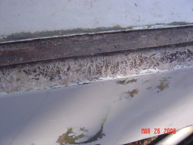

This is the situation:
1- Toe rail is out and the deck/hull join is clean and without the gelcoat.
My idea is to make a solid & even deck/hull join and pripare for a new wood toe rail "flat" in the base (side in contact with the join) NOT like the original.
POSIBILITIES:
1- Build up with cloth and epoxy that "edge".
OR
2- Pour epoxy + silica + chopped glass with a long strip of wood as a container.

I understand your point but as you see in this picture there is only a few inches in the area I have to fill. I am thinking only make even the "hull" part with the "deck" part... later I will install the new wood toe rail.
Why?
Why not just repair/refinish the corner, repaint, gelcoat, whatever, then make the toe rail rabbeted to fit both planes.

Dave took the words right out of my mouth. Why are you looking to change the setup for the repair? Why not mill the new section of toerail to fit as original?
