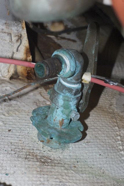

ok. i have an easy one for you guys. how do i remove this through hull? it is the raw water inlet for the atomic four on my newly acquired pearson trition #345. the basket on the exterior had just one tiny little screw that cam out easily. but then i can spin the flanged nut on the inside, but i don't really see that the flanged nut has anywhere to go. does the large flanged part spin free of the threads that the flanged nut are using to tighten it to the hull?
i hope that made sense. i have discovered a rather large shell has grown on the inside of the basket!

You lost me a little bit at the end there, but I think you have a valve body with female threads in the lower half that was screwed onto the male-threaded part that incldes the strainer on outside of hull. If turning valve counter-clockwise does not unscrew,then maybe strainer is covering thru-hull [male part] that is turning also....i can solve this problem in 8 letters: Sawszall

Either start taking it apart further up working toward the hull, where it will explain itself to you, or go with the "sawzall" solution.
You might want those parts some day. That "basket" assembly is a very neat piece of work. Get some penetrating oil and larger wrenches.

Is this one of those weird sort-of-one-piece strainer/throughull assemblies that I have seen on several other Tritons and removed with pleasure and abandon?
What are your plans? In other words, are you removing this through hull because you are eliminating it, or servicing it, or replacing it? Don't waste your time saving stuff that you have no intention of reusing, but if you find the old fitting valuable for whatever reason, it will greatly change your removal approach.
Re: Water Inlet Through Hull
ah, fuzzy memory.
Yes, I think the large "cap" is supposed to spin free of the top of the barrel so that you can get the hull compression flange off and send the barrel out through the bottom of the hull.
BUT,
It's been on there for-friggin-ever. It will not surrender easily.
You really should have a proper seacock there anyway.
Sawzall.
BUT,
Sawzall.

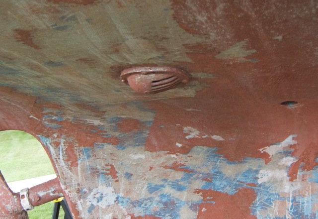

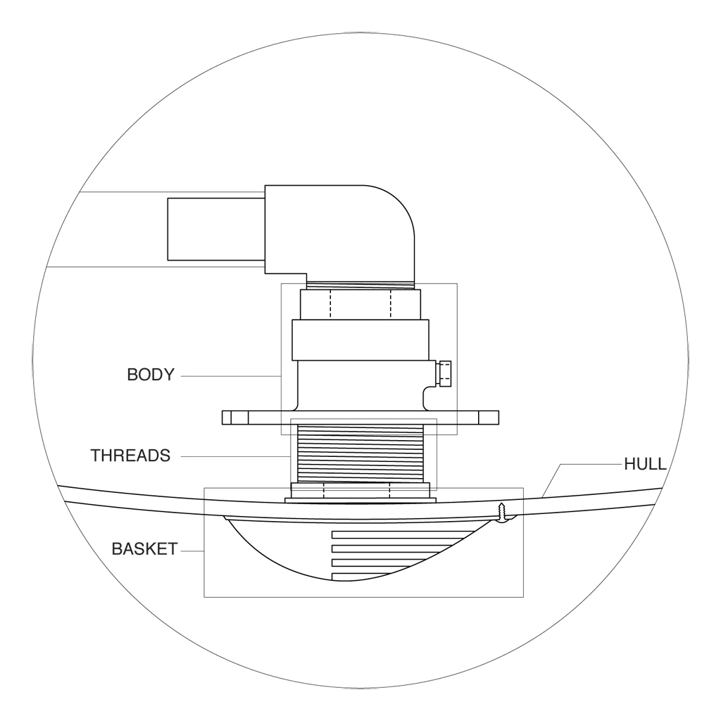

here is a pic of the outside basket. Also, here is a quick drawing of what i can see of it so far: are the 'THREADS' and 'BASKET' one item that are then screwed into the 'BODY'?
i was thinking to remove the whole through hull because the full sized shell that had grown inside the basket made me think that i wanted to fully check the whole thing out carefully. having slight second thoughts now. could have just pulverized the shell through the basket. maybe.
my first option is always to reuse to save money and materials and the like, but i am not adverse to making the decision to just go with the sawzall option and installing new.
thanks again,
carter
thanks again,
carter

I have certainly seen new ones where the basket and the threads are one piece (and the body is separate). If it is that type then the basket and (male) threads went in from the outside, and the body (with female threads) went on from inside.
When I redid the engine intake seacock on my A-30, I put in new stuff. I upped it from 1/2" to 3/4" (since I was changing things anyway), and I also removed the strainer entirely from the outside, and just went with a regular through hull. I was adding an inside strainer (the tall type with a glass cylindrical body with a screen inside) and I figured I'd rather be dealing with any clogs inside the boat at that strainer vs. outside and halfway down the keel. By the way, the inside strainer was separate from the seacock and across the way (I've seen some that are part of the seacock but that seems like way too much potential leverage if something falls against it, so they don't appeal to me).
I think if I were going with an outside strainer, I'd consider one of the ones that you can hinge open for cleaning.
(I think the no-strainer-on-the-outside thing is not a universally accepted best way, I feel that I should mention.)

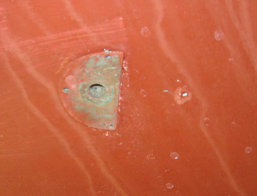

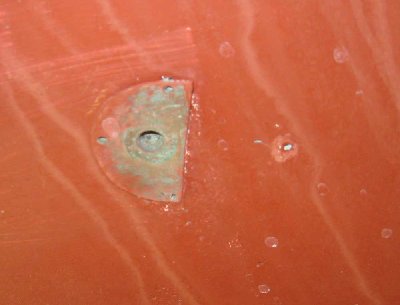

Here is a photo (attached below) of one thing you might find beneath the basket, which I was trying to describe above. This is another Triton.
The external strainer comes off with several screws, revealing this little plate that is an integral part of the through hull fitting/threads, as it were. If yours is original, it may well be one like this. (It may not, too.)
In many other cases, there's a regular through hull fitting located beneath the external strainer, which is not an integral piece.
Remove the external strainer and see what you have.
On the inside of your boat, that flanged seacock is screwed onto the threads of a fitting that is also secured with a flange nut. The whole arrangement is weak and lousy, and you should reconfigure. If you can unthread the seacock without a fight, do so. It will either come without too much effort, or it won't.
Alternatively, you can probably cut the threads beneath the seacock flange, where they are exposed above the flange nut against the hull, and deal with getting the remaining threads out of the seacock body later. This will destroy the through hull, but might save the seacock (which is the pricey part).
Oh that's interesting - I've never seen one with the little plate like that.

the external strainer seems to be integral to the threads i can see on the inside. i can undo the flange nut a bit and the whole thing gets loose. so i think i am going to first try tightening the flange nut back up, and see if i can get the 'BODY' to unscrew off the treads. if i can't, hello sawzall, and start i'll start fresh.

How can the queen of bronze boat parts not know about that half plate thru-hull design?! I have several on my boat and I thought they were readily available.
I would definitely cut that ugly thing out of there. But I am known for taking rather extreme positions sometimes. I would want a proper seacock.

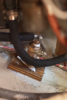

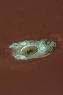

just a final follow up.
i installed a fancy groco. ($150+ w/ all hardware. yikes!)
in my haste i used a plywood pad with several coats of epoxy. i would have rather used a figberglass pad. will probably swap out in off season when i redo ALL the other through-hulls.
-carter
-carter

I'm curious about the elbow/PTH connector on the top of the seacock. Would you happen to have a closer up photo of that?
carterskemp
- Posts: 54
- Joined: Wed Sep 23, 2009 9:57 am
- Boat Name: Hali'a
- Boat Type: Pearson Triton #345
- Location: Bristol, RI
it's a Graco full flow elbow, the space above the through wasn't conducive to getting the hose to make a nice turn.
here is a pic of it off of jamestown distributor's site:
Thanks! For some reason the original photo looked completely different to me; like maybe it was some kind of elbow I had never seen before, or maybe a reducer + machined brass elbow. The Groco "full flow" elbows seem like good ones to me.
