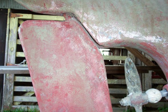

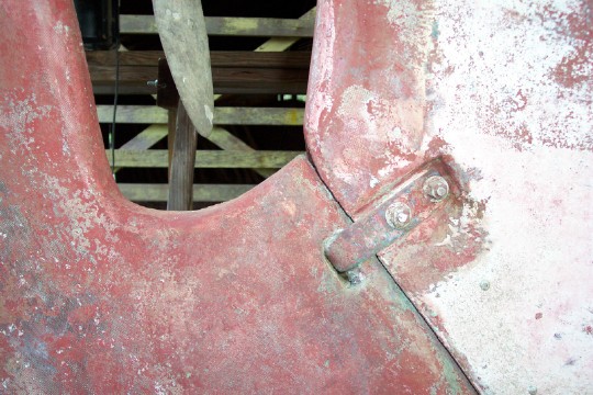

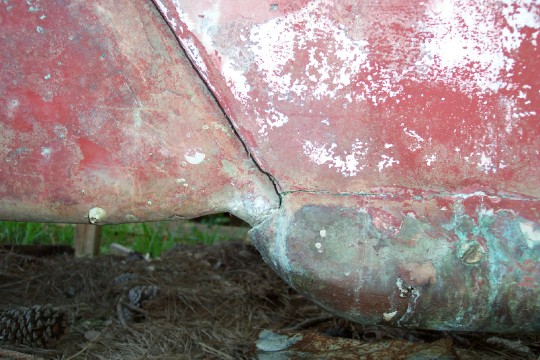

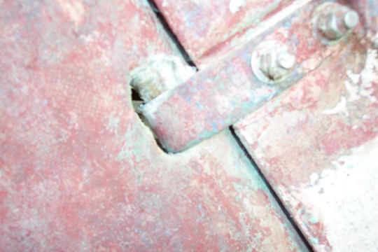

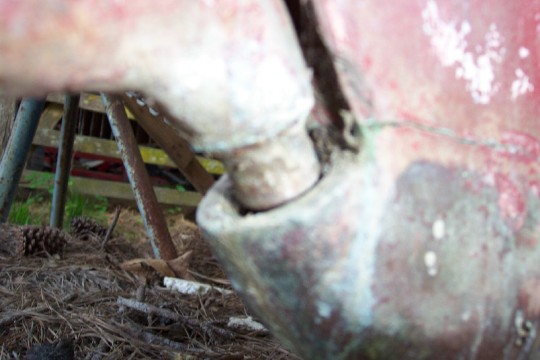

I might be a little late but I took a few pictures of my rudder for you so you can see what is under water. i have a Bristol 27 #200.

Thank you very much for the pictures Lloyd. I did go for a swim last weekend, (6" visibility, 55 Degree water temp, BRRRRRR). I was able to give the rudder a good shaking and determined that the "Play" I am feeling in the tiller is actually coming from the point where the rudder post fits into the rudder shoe. There must be a very short bushing down inside there that seats the male post of the rudder. I only lifted it an 1/8". One would think it would just drop right back down into it..
Your greatly appreciated photo's give me a much greater level of comfort and peace of mind that my rudder isn't going to just suddenly drop out of the boat.
Thanks to everyone for the input on this subject. My plans are to loosen up the tiller attachment yoke and see if the rudder shaft will reseat. Which is probably what I should have done in the first place.
