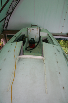

Haven't posted in awhile but thought I'd give an update on the progree of 227. She's made the trip from Conn.and is now in her new temporary home along the shores of the Bras d'Or lake in Cape Breton in Jens Sauer's Boatyard (here's the link if your interested, Jens does excellent work: http://www.boatbuildingcanada.com/index.html.)
Thanks for the cradle plans Steve Scoll! She's sitting on your cradle in these pics! I've got her stripped off and ready for sanding. I think the cracking and crazing issues are a little daunting so have decided I should cover the deck and coach roof with a layer of fibreglass and fair that, as opposed to dealing with the crazing. I haven't even considered the hull issues yet, but clearly, looking at the water leaking out above the ballast I've got some major work to do there.
I am posting a few pics, one of which shows the extreme crazing I am dealing with. I would appreciate any tips or comments re my intention to cover it with a layer of glass, such as cloth weight fairing and just general dos and don'ts from anyone who has gone this way.

My gut reaction is that you should grind off all that gelcoat and enough more to be sure the crazing/cracks are gone. I think buried crazing will eventually telegraph through the new finish. A thickness of glass won't hurt but if you have not removed much then I would not think there's much point in adding some. I think there's lots to be said for a nice, uniform substrate for a finish.

I would tend to think "grind gelcoat off and start fresh" myself. Also, if you have any wet core or de-bonding (or both) you could take care of it and lay down a new top skin over those areas.
That's not to say either way would not work though.

Yes, I am going to sand off the existing gelcoat before applying the fibreglass. Fortunately the deck is solid, so I won't have to worry about recoring.

I may claim some expertise on carpentry subjects, but for fiberglass subjects I am an amateur like most here. But thanks for the kind words. But since I am replying here I will say that I also am a fan of removing problems vs. trying to cover them up.Quetzalsailor wrote:
But, I await Tim or Hirilonde to have the real dope.
Factor in also that Tritons, like many of the boats of the 60s are over built. They don't need more weight. Once you finish sanding I would go straight to epoxy filler fairing and finish sanding.Scott wrote:Yes, I am going to sand off the existing gelcoat before applying the fibreglass.
