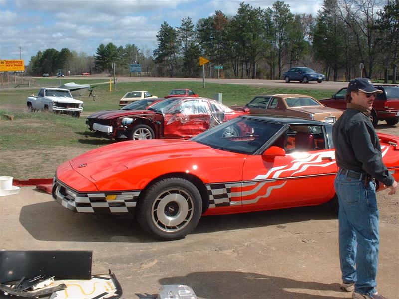

Thanks Rachel I always forget to put a smiley there :-) While I'm typing I am smiling thinking others see it the same way. One of the bad things about typing vs speaking. Some of the A&Ps are very good while others not so good.
A couple of my projects.
Dan
Dan

And next.... a Triton!
Looks like she's in good hands :)
