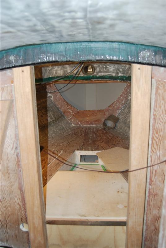

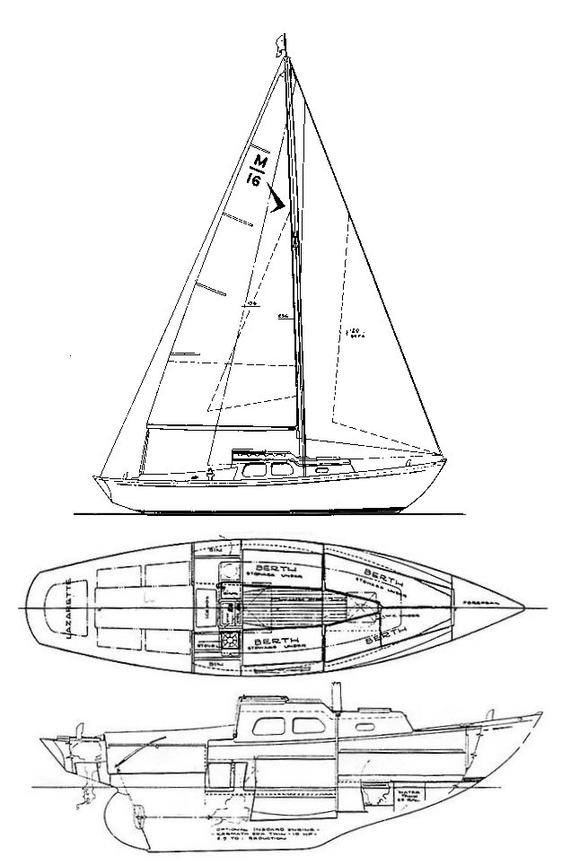

These are photos of a Seafarer Meridian (Rhodes/Jannace design). This is a 25' footer that is pretty similar to the Commander in overall dimensions and style. They were built in Holland in the early sixties, and the builders used fiberglass for many of the interior furnishings (although it was more "stick built" with fiberglass vs. utilizing a liner, if that makes sense).
Edited to add this drawing of the Meridian. Basic stats are (about) as follows:
Length: 25'
Beam: 7'
Draft: 3' 3"
Displacement: 5500#
SA: 250
The mast is deck-stepped, and as you can see, does not utilize a compression post but instead is stepped over a bulkhead. The bulkhead in this case is fiberglass with a wooden core (much like a deck). It's about 3/4" thick. There is no "beam" per se, but there is a thickened "shape" on the forward side that runs across the top. You can just barely see it in the second photo (I have some better photos of it that I can post later - they show the forward side). Basically, the "beam" is wider at the bottom (maybe 2") and then tapers back in before it reaches the overhead (and of course the whole bulkhead is tabbed to the hull). There is no direct connection to the keel (which is external cast iron).
I have not heard of any failures of this beam, so although one might have occurred, I feel pretty comfortable in saying it was not a typical problem in these boats. I don't know for sure what is inside the thickened profile but I don't have any reason to believe it was anything "special."
The other thing that occurs to me is that the Ariel is a nearly identical sister ship with the same hull (but with a larger cabin and smaller cockpit). The Ariel has a deck stepped mast with a passageway beneath it (and no compression post). I have heard of a number of Ariels with sagging beams, but my guess would be it is not so much the size or design of the beam, as it is the execution/attachment -- somewhat similar to the Triton (where you could find a knot right in the center of the beam or etc.). So, you could probably get some good specs from the Ariel.

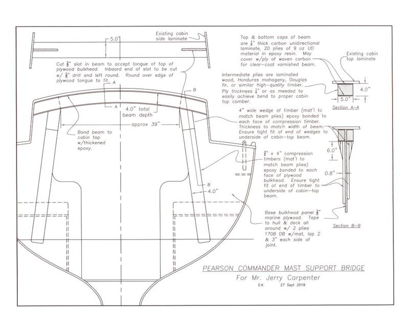

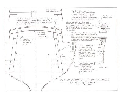

Well...after feeling unsure of the actual design specs needed to support my mast and knowing I did not want a problem down the road I decided to enlist the help of a professional.
I started off by sending an e-mail to Jim Taylor who designed the entire Precision line including boats up to 28 feet that used strong back designs. He has also been involved with the design of the Sabre Spirit a 36'-8" daysailer along with 5 other Sabre boats. And that just touches the tip of the iceburg for what Jim has worked on. When I contacted him he put me in touch with Steve Koopman who is the marine structural engineer that Jim partners with on his designs. Steve's business is SDK Structures and he has been involved in projects like Alinghi, and Speed Dream - the quest for the fastest monohull on the planet. So I feel very comfortable with his ability to produce sound structural design work.
The cost to have Steve provide me with an engineered design that would allow me to safely support my mast turned out to be in my opinion quite reasonable. So a deal was struck and Steve has designed my strong back for me. Unlike most Ariels and Commanders my strong back has a pretty wide unsupported area that is designed to be as wide as 39". I wanted the more open feel that this would give me in the small commander cabin.
Steve tells me the loading on this beam came in higher than either he or I had first suspected. He told me the compression loads are maxing out in the 7000 lb range. So to manage the load with my 39" wide unsupported span I will be using carbon fiber caps top and bottom on the laminated mahogany beam. Here is the design I will be using see the first picture below.

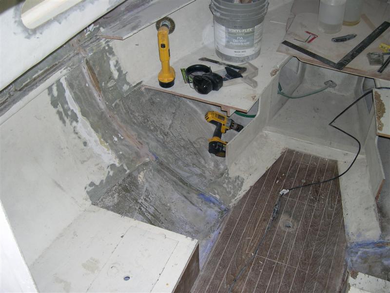

As of this last weekend the old bulkheads are out and the old tabbing ground down a lot to allow for the installation of the new bulkheads and beam.

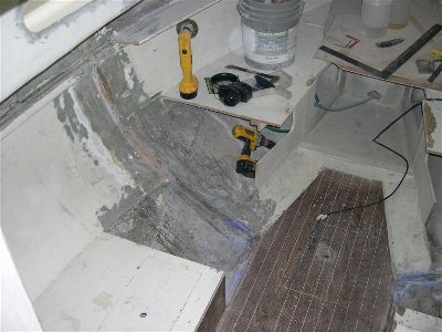

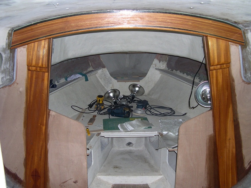

I thought I would share the completed mast support beam I built from the design that Steve did for me. The two black lines in the beam are each 20 layers of 9OX unidirectional carbon fiber.

Looks really nice - I like the wood/black contrast.
