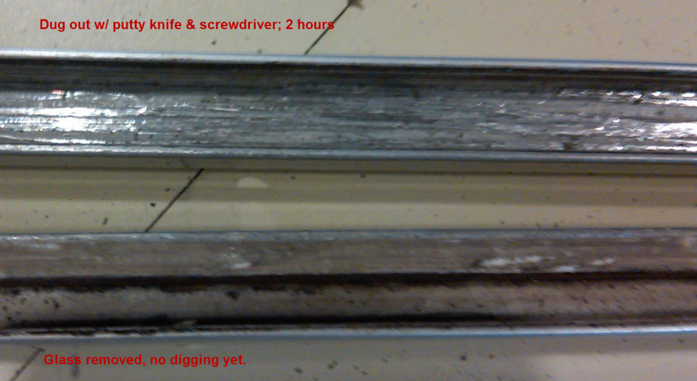

Many winter night hours later I have the aluminum channels "dug out". Adhesive remover had little affect, SS (by hand) wire brushing had no affect and the Dremel SS wire brush couldn't really get into the channel. But by hand I have these channels as clean as shown in the (top portion) of the original picture, which I hope will suffice.
Now to re-build. New plexiglass has been cut.
The bottom portion of that original picture shows the channel before clean-out with just the glass removed;

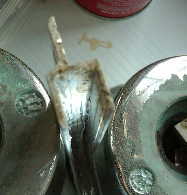

The photo in this post shows a cross-section of the frame, each port has two frame halves that butt together around the glass at 3 and 9 o'clock. , and the frame-flange will be bedded and thru-bolted to cabinsides.
So... what to re-bed the glass into the frame channels with? Anyody know of sources for weatherstripping-like products that will give a good seal? Could a thin layer of silicone on the exterior wall and butyl tape packed on the bottom and interior wall of the channel work? I have tons I bought from MaineSail. I know first-hand that silicone is evil but the next owner will be stuck and by then, the aluminum frames will be toast anyway).
I will definately re-bed the assembled frame to the cabinside with butyl tape.
Thoughts? Thanks.
Thoughts? Thanks.
