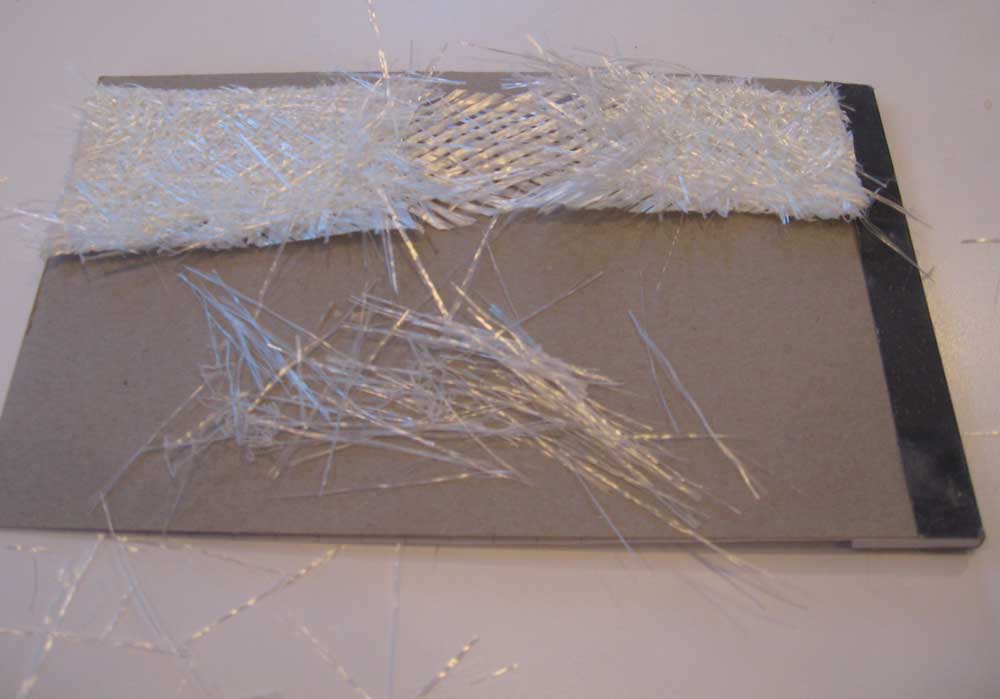

Here's a photo of the partially-dismantled biax as described above. I didn't want to disrupt the flow of "nice" pictures with one that was all business.

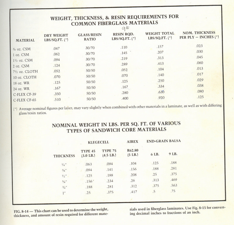

I'm guessing that's because it's a square yard of actual cloth, and since it is 50" wide and not 36" wide, some is taken off the length to make up for it.
36 x 36 = 1296
50 x 27 = 1350

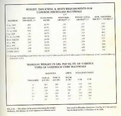

Very interesting Zach, and the part about the mat being "weighted" by the square foot answered a question for me. The fellow who was talking in italics in my post above had said the "08" in biaxmat 1708 was .08, and since I had heard it was about 3/4 oz. I was thinking it should be .8
But of course there are 9 square feet in 1 square yard, so the .08 becomes .72 and it all makes sense :)

36 x 36 = 1296
50 x 27 = 1350
