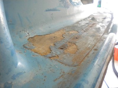

Has anyone found a good way to remove non-skid?
There are a couple spots where it looks like it has popped-off clear down to the gel-coat, but for the most part, it is very tenacious.

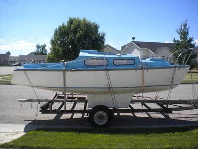

I am stripping paint off my boat in preparation for re-painting. I am using Franmar Soy-Strip and a carbide scraper, and neither seem to do much to the non-skid.
I will also be getting a Random-Orbital Sander soon. Should I just sand it off?

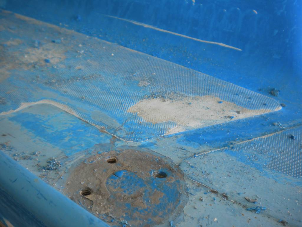

Figured I'd better report back on how the non-skid removal is going.
I purchased both a Porter Cable 7335 Random Orbit Sander and a Milwaukee 10amp 4 1/2" grinder.
Northstar, you were right-on with the suggestion for the flapper disks on the grinder. Those things really make short work of it, compared to anything else.
And I totally love my Porter Cable Sander. The vacuum hose attachment cuts down on the dust considerably, and makes me wish that my grinder had an attachment also. That thing throws quite a bit of material into the air. As Rachel predicted, I ended up looking like a smurf by the end of the day. When I came in and took my socks off, even my toes were blue!
