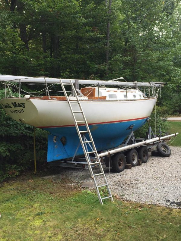

Let me try to post a couple pics. She's looking a bit sad right now, as I just stripped the deck of everything (almost done). I sounded the deck tonight and was actually pleasantly surprised that the soft areas aren't as large as I had thought, so that's a plus! I recored the whole bow section of my other boat, a Kells 23. I don't find the job to be as onerous as people make it out to be. Luckily, I kind of like the work and it's become something of a hobby.

Hmmm, I tried to post a few pics but only one shows up. I'll have to have my teenager help me with that!

Leah May is looking very good Sean , I love a reverse transom . From your picture I see a Aluminum toe rail with the oblong holes punched in it . Good thought though , how does powder coat hold up in a marine environment ? I have no idea , and honestly If went to the trouble and then it started getting nasty in 5 yrs. I would have rather I wen't the wood route . Your Alum. rail does not seem to go the full length of the boat . OK I just found a picture of a C&C Corvette with the set up you describe , the Alum. on the outside of the teak (Captn'K why cant I copy and paste ?) I would need to see more , but why can't you just get rid of the Alum. toe rail ? there is prolly a good reason . Epoxy is your friend for filling holes , but you knew that .
I'm thinking maybe C&C put the Alum. there for rigging attachment ? Good work Sean , you will figure it out .

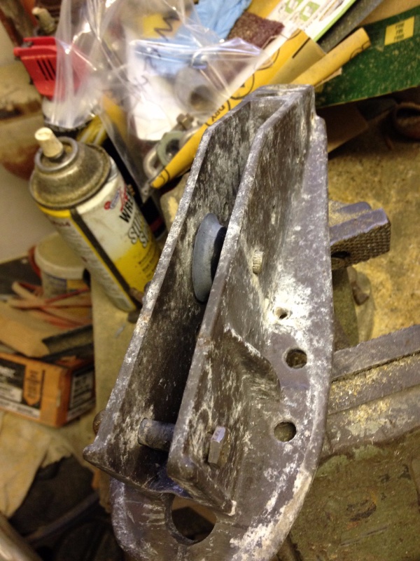

For reasonably small pieces (certainly not your long tracks), a viable and surprisingly easy option is DIY low current anodizing. I just did a bunch of old cleats and spar fittings on an old O'Day 222 I bought to teach my kids how to sail on. Like you, I thought the parts were in fine enough shape, just very crusty from old corrosion and much of the original anodizing had finally worn off. The bead blaster cleaned them up very nicely. There are a lot of how-to videos on YouTube, but I thought the best was from the people I bought most of my supplies from: Caswell Plating. It actually was fun to do.
Now, full disclosure. I'm only just reassembling the spar pieces and remounting the cleats. I'm under no illusion that the thin film the LCD method utilizes will be as durable as the original factory anodized finish, but I also plan to augment the finish with a real wonder product I've tripped across in recent years for aluminum. It's a clear polymer ceramic coating that you just wipe on. It dries to a very, very hard and somewhat slick clear finish. So far it has been really durable where I've tried it (t-tops, pipe towers on motorboats). It's designed to bond especially well to anodized aluminum. Doesn't hold as well to plain untreated aluminum. So, to me, I think I'll have good durability results even with the relatively thin anodizing film with this product on top. It also holds well to polished stainless steel, and can really save on maintenance on stanchions and fittings.
IMHO, I would not waste your time with powder coating. It will look beautiful for a couple or few years, but you'll see it flaking off eventually. Doesn't hold up so well to abrasion and nicks, either. That's what usually starts the larger areas peeling and flaking. I'll try to post a before and after pic or two if I can figure it out. Just joined.
-- Paul

Here are some finished samples
paul45c
Posts: 10
Joined: Tue Jun 18, 2019 5:27 pm
Boat Name: Moray
Boat Type: O'Day 222
Re: Old Aluminum bits and pieces.
Post by paul45c »
Here's one before the work

atomvoyager wrote: ↑Mon Jun 24, 2019 8:01 am ...so it may be the surface prep, coating process, and how fasteners are installed makes the difference - just like painting.
Agreed, James. Making sure that aluminum is as contaminant-free is key. You cannot degrease enough, before and after blasting/grinding/chemical stripping, etc. Powdercoaters are supposed to do this prior to their usual sandblasting prep, but I often wonder how diligent they are in the large shops. I've seen parts from the same shops vary widely in how long the finish adheres, so I suspect it varies. Personally, I've had Awlgrip that I've applied last longer on aluminum than any powdercoating. And it's also vital to repair any chips or dings as soon as they appear, because this is the pathway for corrosion to really get a foothold; tougher to touch up powdercoating.
And you sure nailed it on installing fasteners. I always keep a tube of TefGel in my boat toolbox. So easy to apply, and makes all the difference. I've had stainless screws and bolts set into aluminum for 15 years with no galvanic corrosion, and you also get the great anti-seize benefit.
-- Paul
