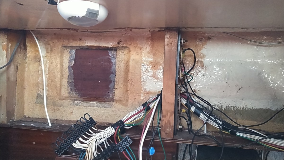

All the wires came in to the panel area from the right, and terminated on a strip on the left. None were of course labelled. I had to initially flip switches and see what did what, and label all the wires. Then I literally cut everything out - scorched earth.

This boat had a nice, well sized and constructed heavily built panel area as you can see - solid ply backing glassed to the hull which was ALMOST big enough for the two terminal strips - I screwed them to wooden slats and screwed the slats to the backing.
