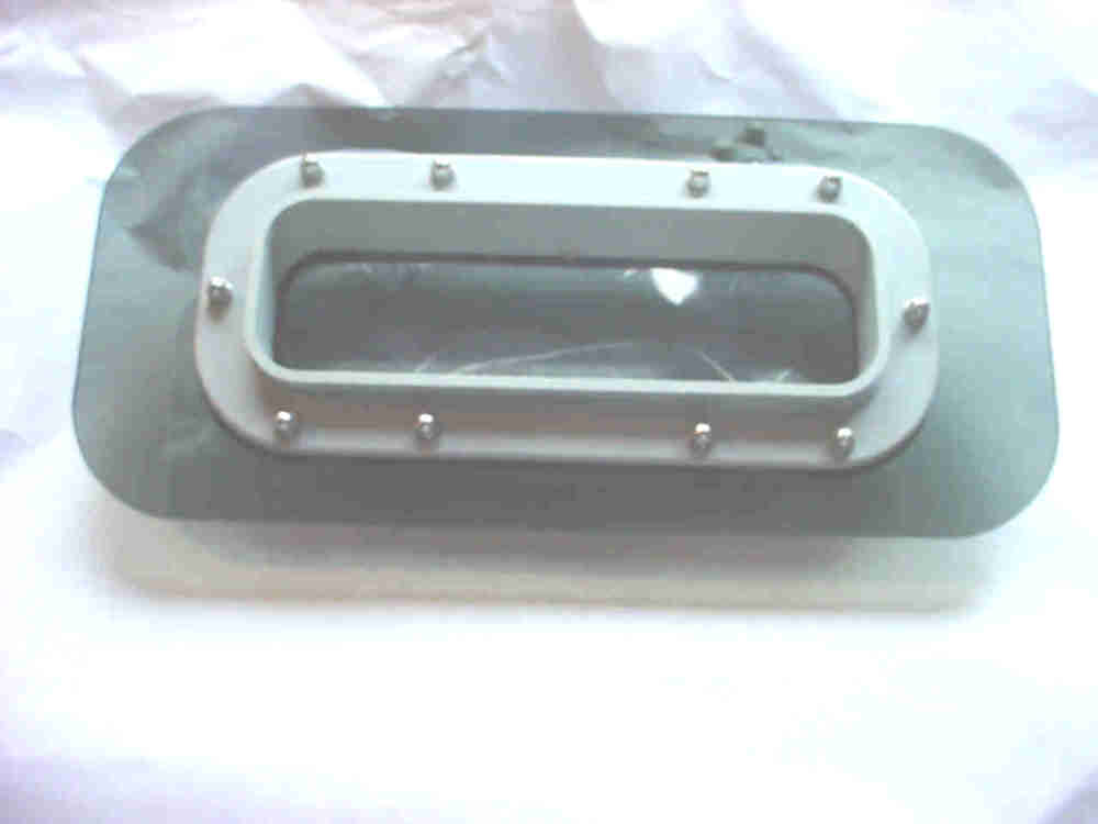

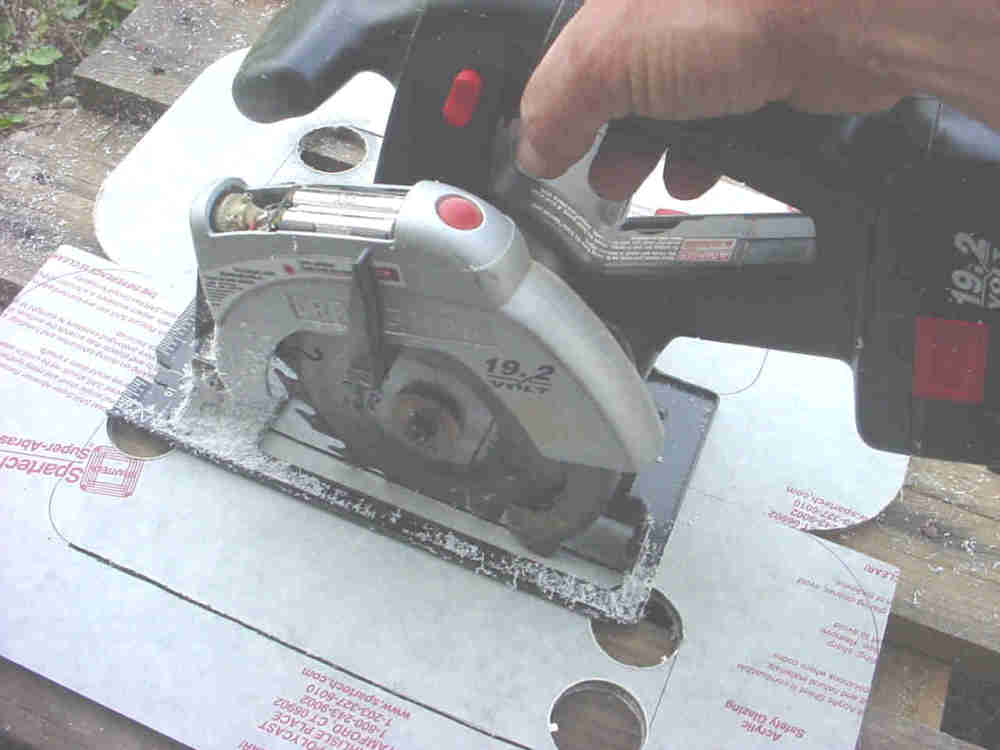

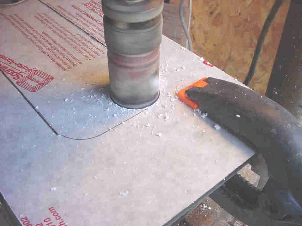

Re: Opening Ports installation in existing portlights-Update
I removed one of my portlights, and after finding the plastic in worse condition than I originally thought, and upon finding the removal quick and easy; I bought enough 1/4" SparTech polycast super abraision resistant acrylic to replace all my portlights. I cut the plastic to size with a table saw and used a band saw to round the corners. I installed Beckson opening ports in 2 of the portlights, following the directions on the beckson website for installing ports in plastic portlights. I used 100% silicone as instructed for sealing. The resulting assembly actually feels stiffer and stronger than the plain portlights.
The tools used for cutting the plastic were: a hole saw for the corners, a battery powered cicular saw for the straight cuts. a recipricating saw for finishing the straight cuts, and a carbide rotary file for dressing the edges. I drilled the holes with a battery powered drill and metal working bits. The only problems with melting plastic were when using the holesaw. I found that short cuts and compressed air solved the problem.
