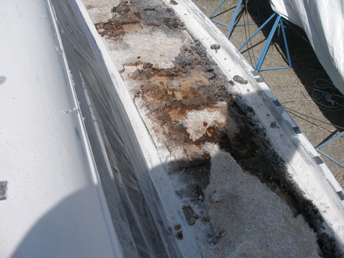

Finally started the recore job today. I thought that removal of the top skin would be a little easier than it was. Some parts of the core were totally melted and the top skin fell away easily, but other sections were still tightly adhered. After an hour with prybar, chisel, scraper, screwdriver, etc. I broke down and went to HD and got the Dremel Multimax. Terrible tool, but it did the job (barely). With many breaks to allow the machine to cool down enough to hold it, I finally got all the core material out. The Dremel POS will be going back to HD tomorrow, hopefully to replaced by something more robust (Multimaster?!?). There's no way I am taking down the other side deck and the foredeck out by hand!
And now for my question. On the photo below, the bottom skin on the cabin side of dotted line is literally paper thin in some places, and painfully thin in most places. In some areas you can see through the open weave to the liner sitting about a half an inch below. The other side of the dotted line is much more solid (probably from the glassed in hull-deck joint). Since its so flimsy and flexible, should I glass another piece of cloth (6 or 10 oz fabric) before I put in the core material? Or just go for the core material?

What you are showing is not unlike most boats of similar nature. The inner skins tend to be very, very thin. Structurally speaking, when the cored deck is all put together and well bonded to both sides, the thin inner skin does not pose a problem. However, it does pose some problems during repair.
Use your judgment about whether to, and/or how much to, reinforce it. You don't need to do so in terms of the strength of the cored deck, but you may need to simply for practicality and the ability to adequately work in the area.
One thing to keep in mind is that if you add material to the inner skin and then reapply the same thickness of core, it will stand taller than the original construction. This can lead to issues if you're reusing the top skin, as it may sit proud of the surrounding surfaces when you reinstall it. This can be a frustrating situation to correct.
You can avoid this problem if you laminate new fiberglass on top rather than re-use the old skin, which I'd recommend anyway (the new material, that is). It sounds as if you had enough trouble removing the top skin that it may have been destroyed anyway, but you didn't say whether you planned to use new material or reuse the top skin.

Thanks for the advice guys. I did use a circular saw to cut the outline of the area, hoping the top skin would come up intact. It did not, so I will be using all new material. I think I will just go ahead and install the core material without reinforcing the bottom skin, since its not a very wide expanse. It should hold its shape, and if it deflects a little bit I can build it back up on top. If I encounter a similar situation in the foredeck, I will definitely be adding a layer though. I can't really add bracing from inside due to the liner, which only supports the foredeck in the middle.

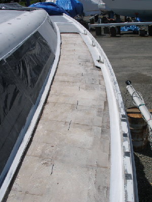

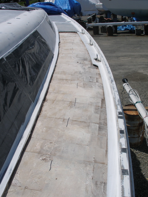

Update on the core replacement- I purchased the cheapest (least expensive!!) version of the Fein Multimaster. What a difference! At full power it blasted right through the balsa. Probably took less than half the time of the Dremel. I can tell i am going to find a ton of uses for the tool. My wife who is sick of my tool habit has even said it was worth every penny!
Its been awhile since I have worked with epoxy and I should have used slow hardener when filling in the gap on the sides of where the new core will go. But I didn't have any available so we went for it. It was midday about 80 degrees and the epoxy kicked too fast and heated the deck up. Only a few little curls of smoke though, so I am hoping its ok! My wife and I had to frantically shovel epoxy around for an hour for fear of it kicking in the pot. So could there be any structural issues from it kicking too fast?
