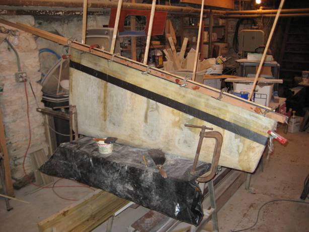

Got started on the rudder rebuild project this week. I'm using two thicknesses of 3/4" BS1088 grade Okoume Mahogany marine ply. Pictures and comments are below.
I used what was left of the old blade to trace the shape onto one half of the ply. I then cut out the rough shape (cutting about 1/2" outside the traced line) using a jigsaw. Next I tacked a batten down to follow the traced curvature line of the trailing edge. This batten was used as a template to run the pilot on the router bit against. I used a 1 1/2" flush cut bit. Produced a pretty clean curve.
Here's a view of the batten/router template from below. I've cleaned up most of the edge. Next, I went around and pulled the tacks one by one and cleaned up those areas. Found this method pretty effective for getting a clean shape.
Here's the first half of the blade nearly complete. I'll need to run around the edges with a rasp and do a bit of sanding but it's almost there.
To cut out the second half, I roughly cut the shape with a jigsaw as before then used the first half as a template and ran the router around the blade. Best method I could think of. Made a perfect copy.
I need to remove the prop shaft so I can remove the top half of the rudder stock. I'm also planning to replace the archaic sealol face seal with a traditional stuffing box. I've done a lot of difficult and nasty jobs on old boats. Plumbing jobs that resulted in being covered in raw sewage, stripping bottom paint, being covered in itchy fiberglass dust etc. Nothing I've done has been as much a pain as pressing out this shaft from the flex coupling. Even after multiple applications of penetrating oil over a number of weeks, I've spent the better part of two days laying over the engine trying to press this thing out. With the limited space back there, you only get about a 1/16 of a turn on the ratchet. I still have about half and inch to go. Hopefully I'll be able to get it out tomorrow. It has resulted in busted knuckles, bruised ribs arms and legs, uncountable things lost to the depths of the bilge (nuts, bolts, wrenches.....) and lots of profanity. If I had it to do over again, I would have taken the grinder to it and had a new shaft made. Live and learn I guess.
This weekend I'll be routing out the cove in the leading edge where the posts will lay. I'm also going to try to get the bolt holes routed out and glue the two halves together.
The previous owner blessed me with 1000 lbs worth 50 lb lead ingots (expensive experiment with extra ballast). I'm going to melt about 10 pounds down and cast some pucks which will be added to the trailing edge.
I'll post more pictures as the project progresses.

Re: Rudder Replacement Options
Looking good...
Some stuff ya might want to ponder:
The easy way to laminate two pieces of plywood together without a twist, is to rip two 2x4's straight, lay them on saw horses and screw from the underside with some screws, diagonally through the side of the 2x4. If you take a long straight edge and lay it on your work bench, I'll bet you a dollar it isn't dead flat. By taking two framing squares and putting them on each end of the boards you can sight down the length, and see if they are out of square...
Now lay the top layer down, clamp it so that it is square, and pop a few 1 5/8 screws in to the top making sure the edge stays straight. I wait to rout the top piece and just cut it close with a jig saw or skill saw until this point... it makes it easier to make an identical copy that fits perfectly smooth to the edge. Make some sharpie marks around the screw holes to ease the assembly. Take a 1/4 inch drill bit and pop a few holes in the top, once every 6 square inches or so...
When gluing, I coat both sides with epoxy and let it sit for a minute, then come back with a notched spreader, and mix some epoxy with cabosil don't mix the epoxy to peanut butter... keep it just stiff enough that it'll hold the peaks of the notched spreader. I use the smallest notches. Now lay the two together, and push down turning the top layer so it beds down and forces most of the air out line up the edge on one side... Change your gloves, put in one screw on one end with a 3/16ths fender washer under it (stainless releases from the glue easier.) Go to the other and rotate the top layer till it is flush around the edge. Put in another screw with fender washer... and now work from the center out pulling down tight. I don't use the clutch on the drill, instead watching for the glue to squeeze out evenly. I put a lot of screws in to the plywood... Say one every 4 to 6 inches, in rows.
Hold the screws like this...
When done, take a straight edge, and lay it on the top of the plywood. If it has some highs and lows, tighten up the screws to pull them out.
Go ahead and take a plastic squeedgee and wipe up the excess that has squeezed out from around the edge, and from the holes on top. Keep the glue out of the screws... (I use #2 square drive stainless screws... the ones i use for laminating get recycled.
When this kicks off, (keep your bucket and don't wipe it out so you know that everything went as it should... and lets you know the status of the glue!) Back out the screws.
I suggest that you wait to fill the screw holes until all your grinding and shaping is done... Vacuuming out the holes just before you start fiberglassing. If you are power planing you absolutely have to wait, or the hard epoxy will chip the blades on your planer. To fill: mix up some epoxy and cabosil like mayonnaise and squeedgee it into the holes with slow hardener... Come back in 5 or 10 minutes and go over it again, as the air will work out of the holes and you'll need a little more glue. Fiberglass the sides with the holes, as soon as you've got the holes full... so you don't have to wait for it to cure... come back and sand and do it all again. If you wait to long the squeedgee marks and goo clumps will be sticky, and fight your fiberglassing efforts.
To taper the blade:
A skill saw riding on a wedge that is the correct taper (thick at the stock and thin at the tip is a very easy way to keep things straight. Make the wedge long so you can adjust it to the trailing edge width...
A power plane works quite well, but that means you can't have any screws in the plywood, which means that any that don't want to come out can't just have the head ground off, and the fender washer popped off... then ground just below flush. So, I tend to stray from the power plane...
I remove the majority of the waste with a sharp 1 inch wide chisel can do if you make your cuts about an inch apart. Hold the chisel bevel down, and just a bit off the line which you want to follow and pare down to your grooves diagonally to the cuts. Just as you would cutting off a wooden plug over a countersunk screw.
You don't have to go down to a feather edge, a 3/16 or so is good so that when it is glassed its a 1/4 inch wide. If it were a foil rudder on a stock, or a racing boat with a naca foil it'd be a different story... but then it probably wouldn't be plywood.
I use a 7 inch hard back 36 grit grinding disc to smooth everything out... since the power plane needs to run perpendicular the rudder stock. The glue lines in the plywood make it very easy to keep the surface fair and smooth. Lay it flat to the surface and move it around and let it do its thing... Save a few discs when they start to scorch the wood, as when you are close, switch to the used one and it'll take a little less wood. Sand with 60 grit on a random orbital when you are done to give a better tooth for the epoxy.
You might consider a hardwood block to take the load on your bolt rod... Just a square with an opening for you to get a wrench on the nut. Plywood doesn't like to be compressed under a washer... it likes to delaminate, or pucker up at the load. Bore the hole a bit oversize for the screws and set the screw into a bed of epoxy and cotton fiber to stop water from tracking down the screws. Glass the leading edge of the rudder at the rudder stock before you put it together, and put a layer or two of cloth around the rudder stock to take some of the load off the screws. I'd also sand the leading edge of the rudder and squirt some 5200 between it and the rudder shaft but I've been known to overkill...
The build schedule I would use: 2 layers of 1708, and 1-2 layers wrapping around the rudder stock. I wouldn't use 17 ounce biax with no mat, as the mat adds a lot to the water resistance of a layup... its very resin rich. The 10 ounce cloth won't help you out to much... you'll end up sanding through it while fairing. I'd mix up some glass microballoons and coat the glass right after you are done air rolling. Personally I think carbon is overkill on a plywood rudder...
For glassing the edge, the easy way is to cut a piece of biax cloth out of the center of the roll, following a 45 degree angle 6 inches or so wide, and another 3 inches wide coat the plywood with a layer of neat epoxy and let it sit for a few minutes, then come back with some cabosil added and smear it along the side... Wet out your glass and put it to the edge. The cloth cut on a bias makes it bend easier since the fibers are running on a clock angle of a 2:00 to 8:00 and 10:00 to 4:00 than trying to get the 12:00-6:00 and 3:00 and 9:00 to take the bend of the outside edge. You can start from forward end of the rudder on one side, and successfully get the glass to take the curve by lapping 3 or 4 inches around to the other side and taking your gloved hand and pushing and wiggling the cloth until the lay loosens and work it around the edge. Basically what you are doing is wrapping a piece of paper around a basketball, so you are stretching one side and asking the rest to lay flat... Cutting darts isn't normally required with a little bit of thinking when you cut the glass.
For the 45 degree cut glass: Put down the 6 inch layer first, followed by the 3 inch... Mark a centerline with a sharpie to keep them even on both sides. Lay your next two layers so they butt at the seams. It puts more glass that is solid on the edge, than you do having to cut darts all over the place to get it to lay flat. Wait till it just starts to go green, where it is gooey but not tacky... Cut your glass to the seam so it just does butt up and glass the rest of the rudder. You probably wouldn't be the first person to screw the rudder to a stud in your garage so you can glass both sides at the same time vertically... then go back and grind/back fill the screw hole...
You can also load the odds a bit in your favor for some longevity, by making a solid edge of epoxy and chopped cotton or milled glass on the trailing edge, bottom, and leading edge up to the lowest gudgeon. Do this after all the rest of the shaping is done, but before glass... You don't want to grind epoxy with cotton fiber or chopped glass... Lay the rudder down on a flat board with some packing tape stuck to the bottom side, and a batten tacked down through it, packing taped... then fill up the moat you've formed with the goo. When it kicks, lay a piece of sheet metal down on the plywood of the rudder and grind down to the right angle... then get it flush with some 80 grit on a random orbit so you don't carve up the plywood. Makes for something that if you end up chafing on an anchor line or back over a cable it doesn't crush the plywood and start taking on water...

Made quite a bit of progress on the rudder over the past few weeks. Almost ready to hang it back on. Got my new prop shaft and cutlass bearing as well so this project should be done by next weekend. Here are a few pictures of the progress:
I decided to route out the bolt passages on each half before laminating rather than try to drill the passages out after gluing the two halves together. Worked out pretty well.
Laminating the two halves was pretty straight forward. I first drilled holes for the screws spaced about 6-8" apart. I then spread Cabosil thickened epoxy with and 1/8" trowel on both halves, laid the halves together and worked the air out from the middle of the blade out to the edges. I then screwed the halves together with stainless screws and fender washers and used c-clamps and some extra weights. I backed the screws out before full cure and had no problem removing them. I used 3/8" OD Pex tubing in the bolt hole passages to keep the passages from filling with epoxy. I waxed these heavily and removed them before full cure without issue.
After gluing the two halves, I wanted to test-fit the blade on the boat. Luckily, all was well. Needed a few minor tweeks but it fit perfect for the most part.
For the taper, I used an angle grinder with a 36 grit disk and a belt sander. I copied the shape of the old blade as best I could.
To add a sort of barrier to the trailing edge, I used a method I had read about in Duckworks some time ago. This is similar to the method Zach suggested above. I soaked a length of 1/4 cotton rope in epoxy and then tacked it along the entire length of the trailing edge. The photo below is after fairing and sanding. This should add some protection to the trailing edge in case I were to back into a line or something.
Here's the blade after the first layer of glass. I'm using two layers of 1708 biax.
Fully glassed and the first round of fairing complete. Just ordered 10lbs of lead shot. Once that gets here I'll bolt on the posts, fill the holes with lead shot and glass over them. One final round of fairing and a few coats of epoxy for a barrier coat and I should be done.
Hirilondë mentioned early on in this thread that a one-off rudder would take quite a few hours. I have found this to be quite true. I probably have 60+ hours and about $500 in this project so far and another 10 hours or so left.

Some good tricks shown here.
Always good to drill, rout, or otherwise provide long holes if and as the assembly allows it. I drilled each board of a solid wood countertop before epoxying the boards together. Since the threaded rods did not extend to the edges, like Robs' I assembled the bolts with their lengths taped as I glued.
The bolt ends can be seen in the recesses milled by plunge cutting with a dadoe blade in my radial arm saw; the boards were clamped to the saw table so all I had to do was crank the arm down the right number of turns.

I like the rope-edge trick, especially if it wet out completely. I might well adopt the idea for the leading edge of rudder and centerboard on the Flying Dutchman project. A negative of such an idea is that the reinforcement would cause more extensive damage if it's hit hard enough, and be more difficult to repair.

Jeeze, I meant to write first that you're doing a great job!
Very nice work!
The rope is a new one on me... Only time I've seen it was on a rolling dolly for a wharram tiki 21, wheels 3-4 layers of 3/4 plywood laminated together and wrapped in rope/epoxied.
Very slick, I'll be using that tip.
