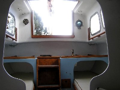

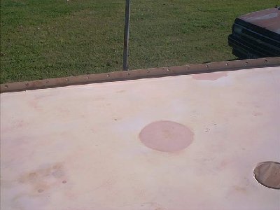

Here is a photo of CJ and Laura's boat, Tehani "before" (clearly with additional paint on top of the original peeling "plaster"). She was slated for the chainsaws the next day:
And one "after." It still looks remarkably like this five years (and a year's active cruising) later:

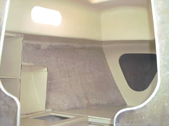

Here is one of the forecabin "during" that shows the new paint:

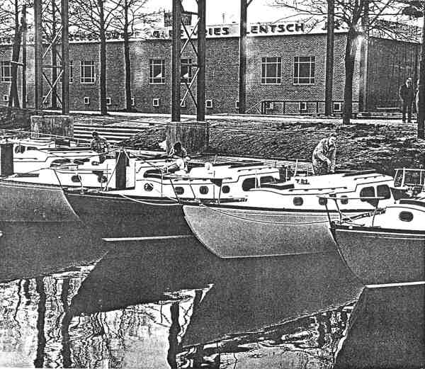

Here is a photo showing the DVL building at Vianen/Amsterdam, with Swiftsures floating outside and being finished up:
Inside (don't even think about the lack of safety equipment... sheez):

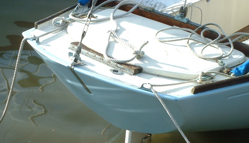

On the Meridian hull/deck joint.... now that's interesting. The hull and deck are (as you say) glassed together, but then... what fasteners do you speak of? The reason I say that is, okay, I see what you are saying for something like the Tripp-Lentsch 29 (also built at DVL same time period), or (I presume) the Swiftsure, because of the way the toerail is fastened*, but the Meridians I've seen are completely different, and like the Ranger. They have a molded in vertical "fin" the protrudes onto the deck about 1-1/2" and then to fasten the toerail, screws go sideways through that and into the toerail --- thus never touching the "real" deck at all.
*For those who aren't familiar with it but who have made popcorn and are following along, the way the TL-29 (and I think the Swiftsure?) are put together is that they attached the toerail to the deck with fasteners (wood screws, I think) coming up from underneath, and then glassed the hull and deck together. So there are no fasteners penetrating into the boat on the hull/deck/toerail joint, except where you have the genoa track sitting on top of the toerail and being bolted right through. I have seen a couple of TL-29s where the toerail was later bolted - in both cases the rail had been replaced due to collision/damage. I've also seen a few small salt trails where I can see what Vark is saying in that the screw heads have seemingly started to wear through slightly in someplace like a cockpit locker where the raw joint is exposed. (What I don't know is the exact order of it, and if there were any hull deck joint layers put on first, then the screws, then more, or what - not that it matters probably). I think, but don't know, that the Swiftsure is put together this same way, like the TL-29, vs. the molded "fin" attachment of the (some?) Meridians and Rangers.

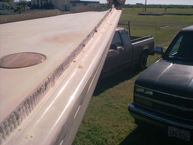

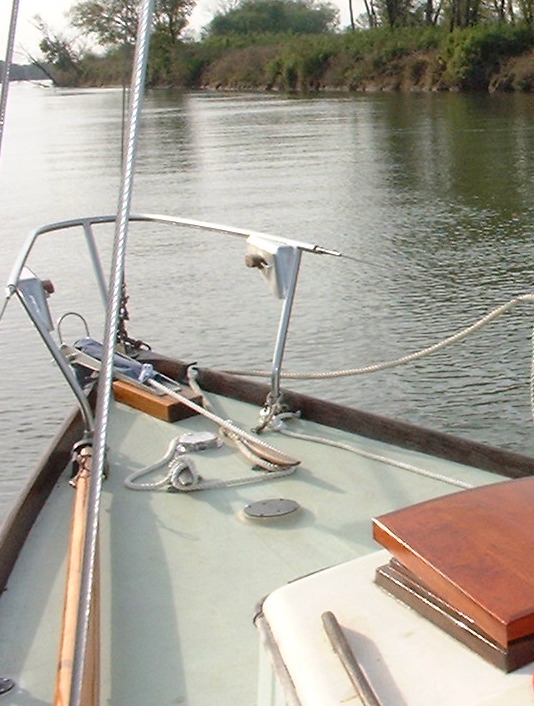

Here is a photo of "the fin" on a Meridian from the outside (with the toerail removed) (#11 I think or at least 1961). You can see how the toerail is fastened from the side, so no fasteners go into the deck in the usual way.
From the inside:
Here you can see both sides with the wooden toerail on:
Now, if there were Meridians built somewhere else (like Jeremy's?), did they have a different arrangement? The ones I've noticed always had "the fin" though, so I'm not sure where the screws are coming from on this design. But of course I would love to know! :D
It's not super easy to make out, but the Ranger here also has "the fin" for the toerail fasteners (#152):
And just to bring it back to Swiftsures (on topic, oh yes), here is how (at least the ones I have seen which is not that many) look --- no fin, and I believe, as you note Vark, that the toerail is fastened "blind" up from below under the hull deck joint (#21):
I have some photos that show the TL-29 where it's fastened up from underneath, but not on this computer.
I always thought "the fin" was a pretty sweet way to attach the toerail. It does block the view of the wood slightly on the inside, but then too you have a little fiberglass waterway instead of deck water just sitting at that deck/toerail joint and trying to get the varnish to peel.

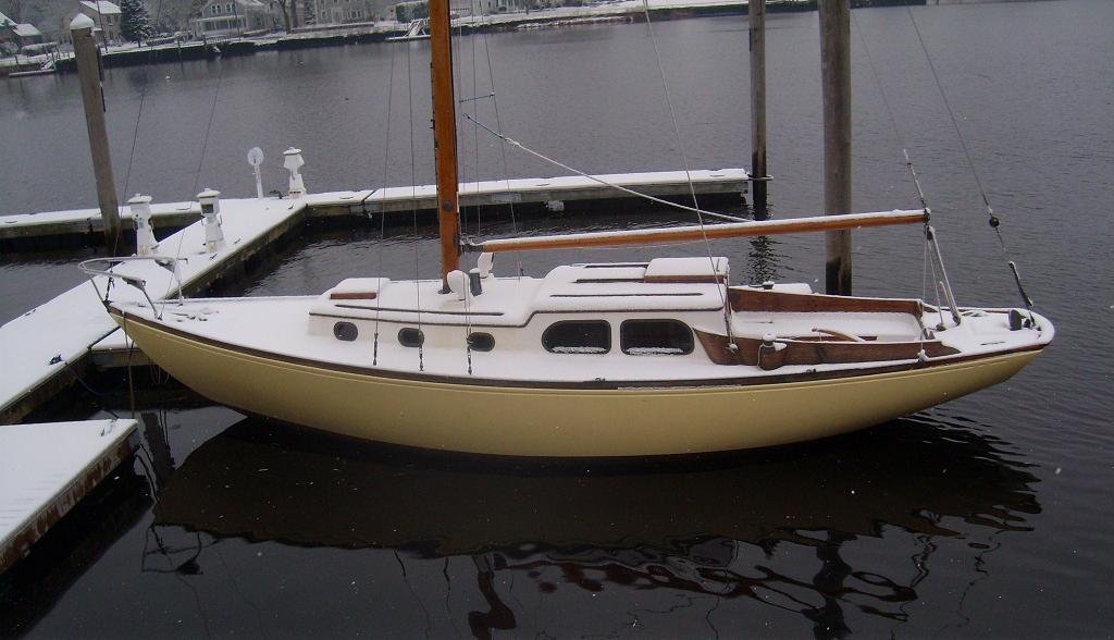

I discovered how to reduce the size of my pictures, here's one for now, others will follow.
I went shopping for a Triton, which I love but came across a Swiftsure and couldn't resist its beauty.
"A thing of beauty is a joy forever"
