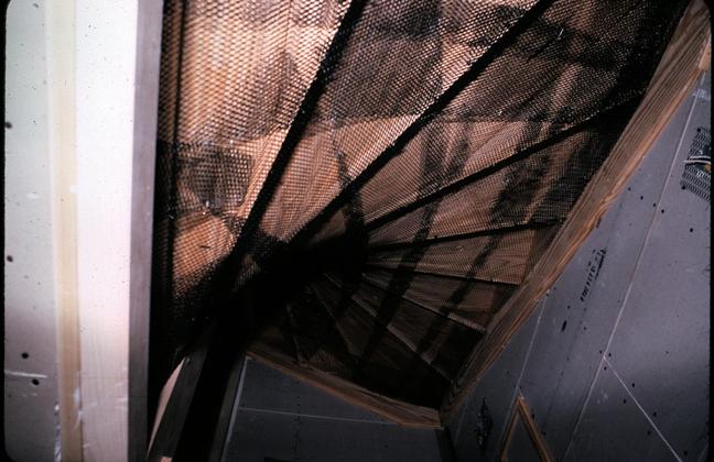

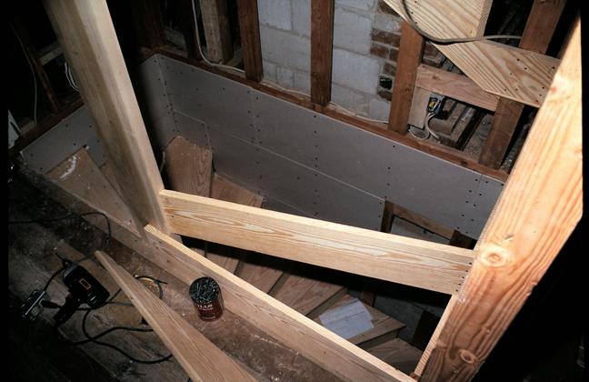

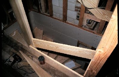

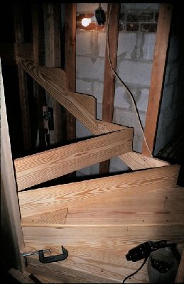

Re: Interesting design for compact stairs
I built winders in my former residence, in about 1977. The house was made from both halves of a twin, each of which had a set of tiny winders. I built the new set just like the originals except that, instead of being in a well about 30" x 60", the new well was about 38" x 74". Made all the difference in the world. Adequately safe in a house; not even my infants had problems with 'em.
I plastered them on the bottom; the originals were lathed in wood. Such a pretty shape!
