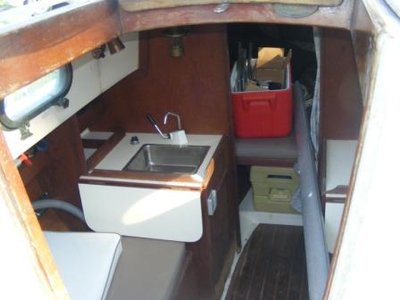

Greetings,
I need some advice on replacing/repairing teak plywood in the interior of a 1984 Cape Dory 22. The boat's interior is in good shape except for one spot. I have attached a photo of the interior, with the damaged area visible at the lower left, just above the cabin sole. Apparently, at some time in the past, the sink drain hose leaked and water pooled up in the base of the teak plywood cabinet, causing the bottom 6" of the plywood to delaminate inside and out. The drain was evidently repaired and the plywood is dry. I now have an area 6" X 18" of discolored and shedding teak plywood veneer. I would prefer not to rip the cabinet out as it is tied in to the bulkhead and quarter berth, and is sound except for the one area. Is there a way to repair this in place?.

Re: Replacing/repairing teak plywood
I thought about just adding veneer and found a source for small sheets. Unfortunately, the plywood in this area is compromised. It's 3/8" and I can push it in and out of shape with my fingers. Maybe I could use some penetrating epoxy to firm up the laminate, then apply the teak veneer and possibly add a thin shoe moulding, with a matching one on the starboard locker. There are no structural loads on the front of the locker, and this is mainly cosmetic, but the rest of the interior is in great condition, and I hate to have shedding discolored plywood in such an obvious place. To be honest, since Cape Dory boats have the reputation of being well built, I'm a little surprised that the plywood wasn't sealed in some way at the factory, given the close proximity of water in the sink.
Agree with you there. Not much space on the cabin sole, especially bending down to the bottom of the locker. However, I might be able to cut out the bottom of the locker front straight across the bottom of the door opening and splice in a new panel with teak veneer without too much trouble. I'll try to get a close up photo.
Unfortunately, I can't mount a foot pump there. There is a fiberglass molding in the locker bottom, almost like a raised floor in the compartment, that the plywood fits against and covers up. I think I'll take your suggestion (shortened jig saw blade) and cut out the offending plywood straight across the bottom of the locker door opening, then splice in a piece of plywood with a teak veneer. Once stained to match, it should be hardly noticable, and I will seal the plywood and drill some drain holes to prevent this from happening again. Thanks for the advice.
