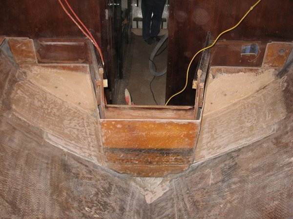

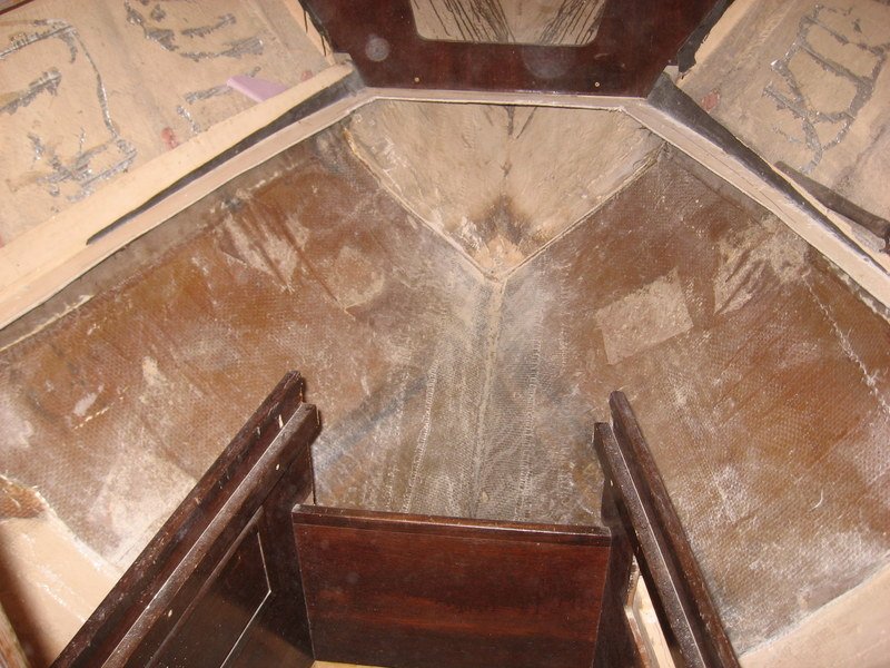

Since the interior liner supports the bulkheads, how has anyone removed the v-berth liner? Did you leave floor pan part in place and reuse part of it or remove it entirely? Any pictures that show what the v-berth looks like after liner removal before reconstruction would be great.
Re: Alberg 30 v-berth liner removal
How you remove the v-berth liner depends on what you are trying to achieve. If like me you wanted to replace the original water tank with an integral tank and maximize storage and collision bulkheads then you can cut away most of the liner but leave the walk through portion and sole intact as in the photos below. I cut the liner away flush to the bulkheads and then added glass and plywood as needed to strengthen the area. You can see the finished job at the beginning of the following video:
https://www.youtube.com/watch?time_cont ... T4N1Fx_rvc
The attachment TimA30Vberth03kb133.JPG is no longer available
You can see some of the liner was kept in place where it was a tight fit to the hull and bulkhead and could be sealed along the edges with new glass.

Thank you for the reply. That is exactly what I was wondering. The pictures show just the information I was wondering about.
