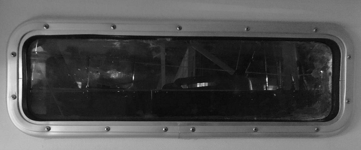

Hello guys I am currently trying to stop the leak in my port late… I have those cheap aluminum port lights that come standard on almost every boat through the late 70s and 80s picture is attached. So far I disassembled the porch light and put it back together using silicon sparingly. I then used butyl tape to mechanically mount the frame on to the fiberglass and secured it from the inside using the screws. However it did not work in fact he got worse… Your advice is much appreciated. Also I was thinking about changing them all out to fancy port lights are open but that would be pretty expensive and I’d have to research all those parts so if this is doable DIY job I would of course hope that could work. Thank you cheers

Hi Ian - Where is the water coming in: between plexi/glass and aluminum frame, or between the frame and the boat? If between frame and boat, based on looking at this picture, you may have tightened the frame too much because I can see where it is bending around the screws themselves. This might have caused the butyl to squeeze out...?
Think of butyl as a caulk, a sealant, but *not* as an adhesive. There has to be sufficient material in there for it to work, and over-tightening can create leaks by forcing too much out.
If you have the space/width around the edge of your cutout and under the lap of your frame to do so: use thin foam weatherstripping in addition to sealant to make sure any gaps due to surface irregularities are filled. I used the black foam strip material, approx .25" thick and wide, adhesive-backed, applied just at the edge of the fiberglass cutout, then put sealant around that (or towards the outer edges of the frame). The foam strip is right in the corner of the frame where it meets the boat, behind the sealant, creating a physical gasket to back up the sealant itself. You cannot tell it is there by looking, you'd have to disassemble the portlight to see it.

svMira and Kurt have some good advice. If you rebed something that had silicone on it you need to thoroughly clean the surface using a varnish scraping tool or chisel followed by sandpaper. I also avoid silicone but do use it on some gaskets and plastics because other sealants are said to react chemically with the plastics/rubbers and breakdown over time. I've seen it happen rapidly in some cases but its hit or miss and often it doesn't seem to react badly at all. For example, I've replaced some lexan and plexi windows that were heavily crazed and the caulking sealant crumbling in the contact zone and leaking badly. It looked like some type of polyurethane sealant. use Dow 795 on plexi and seems to work very well. Maybe you could use butyl or other types of sealant caulk on the plexi but some experts don't recommend it even though in many cases it could work fine. I can't say. You need to address every surface in the assembly, such as frame to fiberglass, frame to rubber gasket, if there is one and rubber gasket to plastic lens. Leave a water hose running above it on deck and look inside to identify where the leak is, then disassemble and redo.
