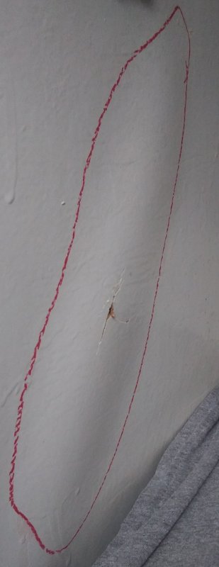

There's a roughly 3"x12" section of bulkhead in the v berth that is delaminating. I assume it is plywood. I'm planning on cutting the section out with an oscilatting multitool and filling in with epoxy and fiberglass. Does this make
sense? Has anyone done something similar?

I can't tell from the photo if that is the top skin delaminating from the plywood or formica on top of ply or something else but cutting into it will tell you what it is. If the other side of the bulkhead looks fine then maybe it's just that top skin coming off. You can use the oscillating tool or even a small circular saw with the blade depth set shallow if you don't want to cut all the way through the bulkhead. If the repair goes deep and the other side is hidden in a locker it may be easier to cut all the way through with a jig saw and patch in new ply with epoxy and a single layer of glass if needed to strengthen it. But a shallow cut first to see what the problem is makes sense. Let us know what you discover.

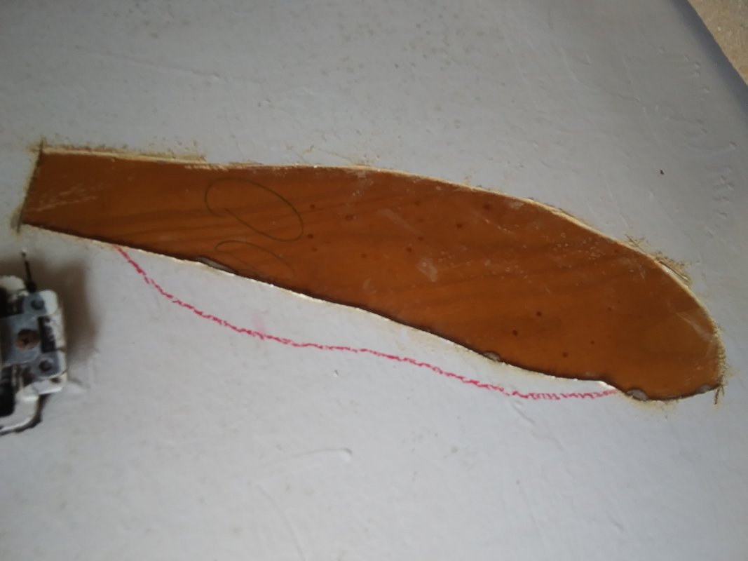

Re atom: I'm pretty sure it's straight plywood, I made a small cut with an utility knife to see. The other side of the bulkhead is in the head, so it would be easy to just cut that section out totally and patch new plywood in (although it's have to read up on how to do that). I'll be gone from the boat this next week, but will update when I get back.

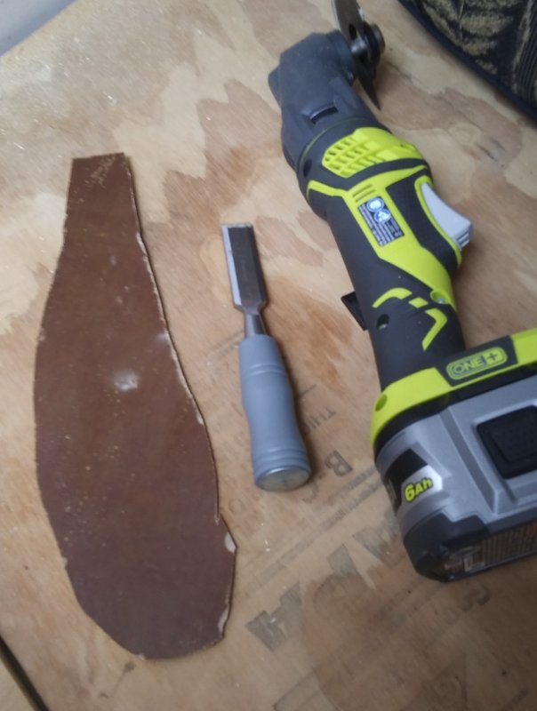

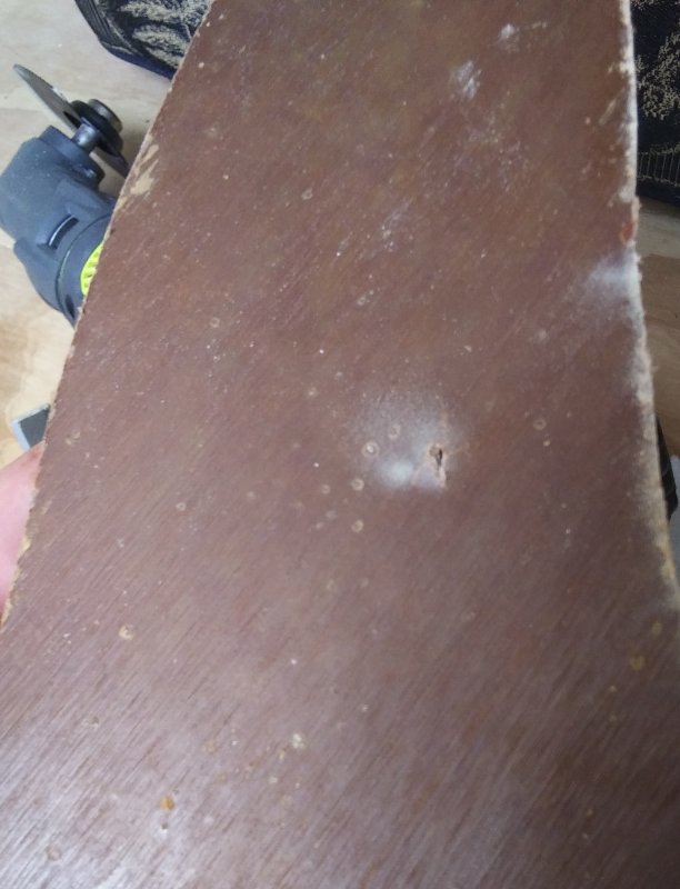

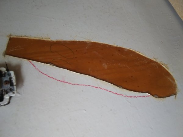

Cut in with the oscilatting multitool (which worked great) and it looks like formica, or something equivalent, on top of ply.
Debating what to do about the patch... The piece I cut out is warped, maybe I'll just glass it - - I'm repainting the interior anyway. I have another section to cut out here; decisions, decisions.

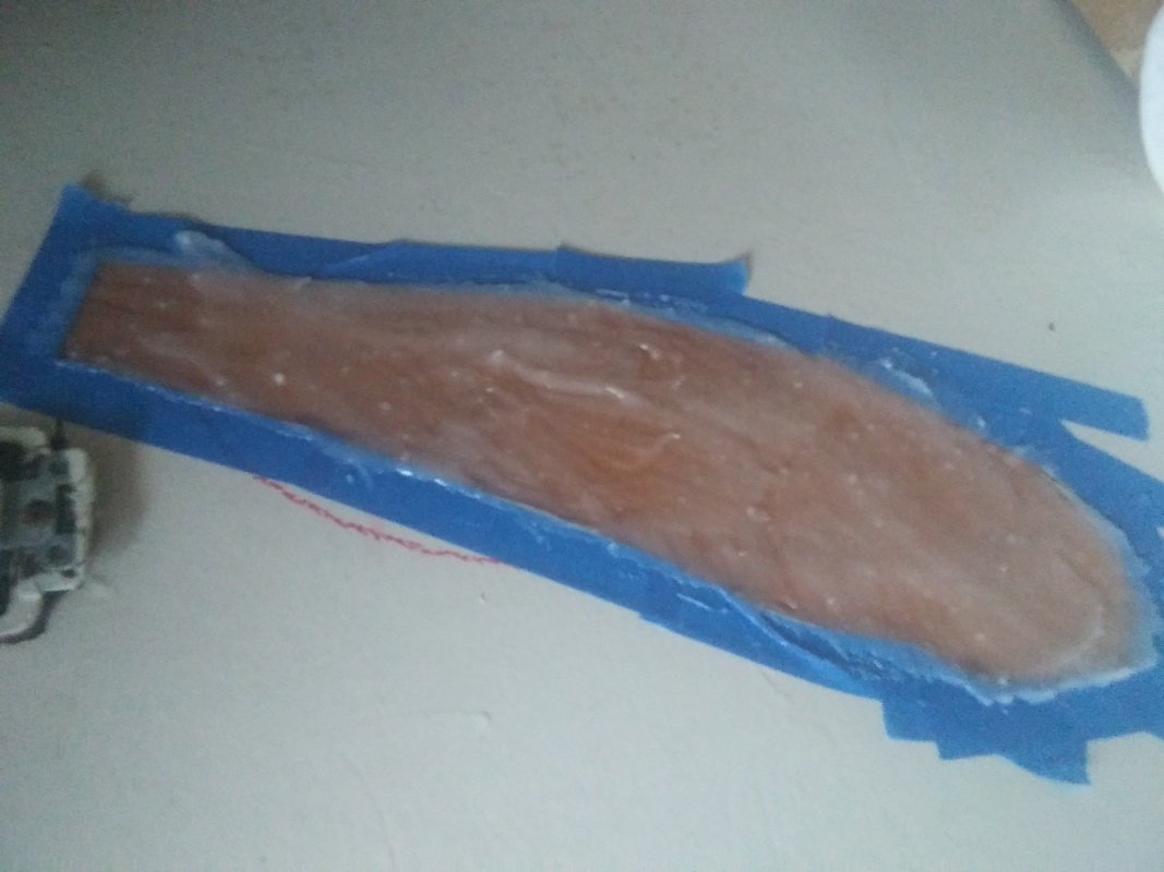

Decided to epoxy it. It was my first time working with epoxy, and added in colloidal silica. Came out a bit too thick, somewhere between mayo and peanut butter. As you can see the finish is bumpy, and the silica wasn't completely dissolved. Going to sand tomorrow.

By now you've discovered how hard colloidal silica (West 406) is to sand particularly when applied that rough. I hit it first with an angle grinder with 36 grit pad or other sander/grinder tool rather than a slow random orbital sander to knock it flat then fill with an easy sanding filler like West 407 and then use the random orbital.
