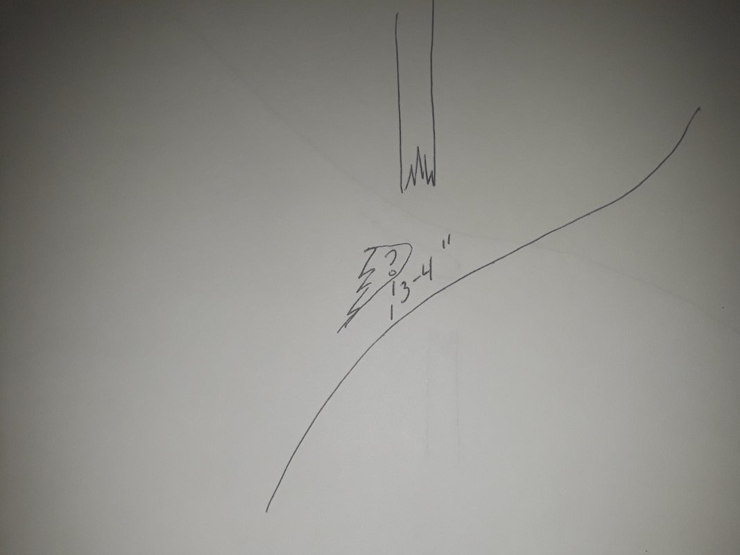

I am looking for ideas about how to support the base, I have looked into as much as I could in to the construction and used a Walbot and have used a deep wall scanner
Although I cant see what is what.. the above photo shows what I can decipher, the object with the ? in it is dense and has no registration on the thermo-scanner. I am guess it is metal possibly.. this is the location in line were the mast support beam would be located.
Any ideas about how to apply the support base in this area.. if at all possible. I have heard and read about others having used one for emergency.
My idea is to place a custom support made out of fiberglass and G10 to the floor building it up so that the whole fiber glassing area would spread support around the hull area about 2' in all directions, slowly building to a maybe 12x12 g10 plate. My thought being the pressure on the g10 plate would distribute all the pressure to the surrounding areas. More or less making a fiberglass molded platform laminated to the hull.

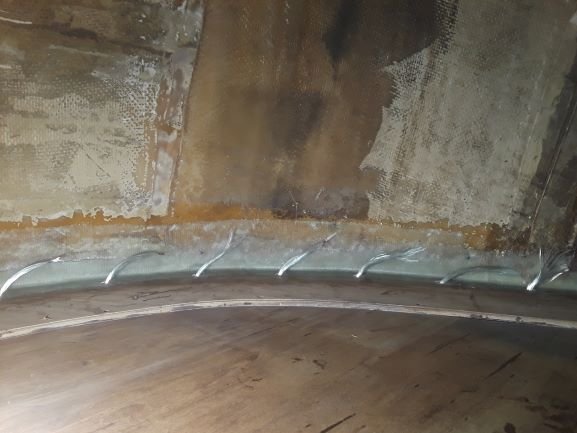

I tend to agree with you that I am over thinking and over building, I don't see any weaknesses in the main bulkhead to be honest, I added made large fillets and fiber glassed tabbed both sides all the way around. Base Bulkhead tabs have 7 layers both sides at hull. and 4 layers across the top with dbl bi axial cloth.
I added 8" ply to the bulkhead along the hull, both sides! Main bulkhead is filleted and 5 Layers of bi-axial then the 8" ply, then filleted again and 2 layers of bi-axial mechanically attached with fiberglass fiber! This is done both sides of mast step bulkhead, I will then fasten it or sandwich it together with SS Bolts.
Now that its completed, the bulkhead walls are extremely stout and firm, Along with the modifications to the step beam supports by thickening them up, This wall will not go anywhere. So you are probably right!
The with the new beam bolted in place with thickened supports and tabbed and glassed in.. now that i think about it.. I am worried I did to much!

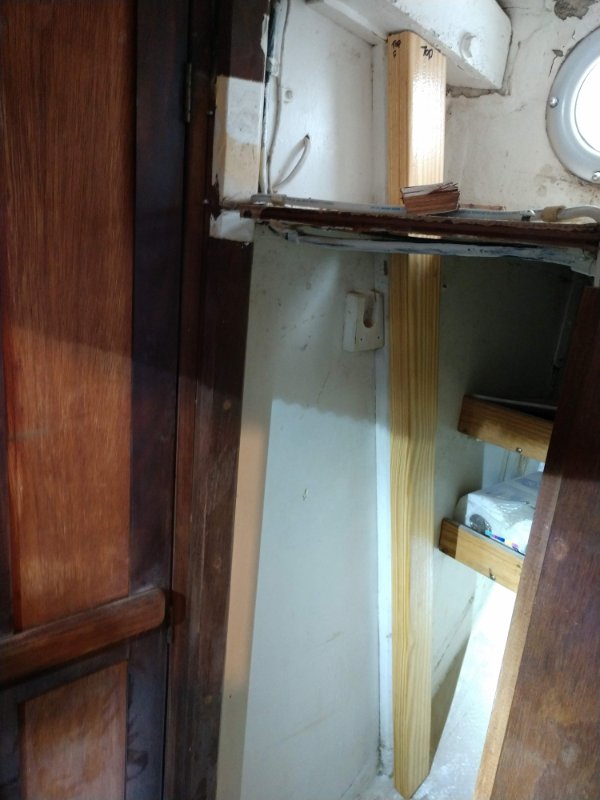

Although my A30 did fine without it the last 53 years or so, i also figured some support wont hurt. So i deemed it sufficient to get some 2.5x3.5x8 planks, and i believe 1/4 x 7 in bolts and washers. I angled the base and top of each of the 4 support beams so they would fit as snug as possible into their designated positions, each bolted with 3 bolts to the original support struts attached on the bulk head. Now i will tab it all in place and call it the day. Cheap and easy fix that should do its job, if this is what you was talking about.
