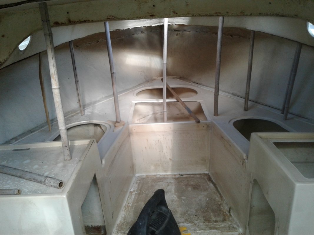

Sitting down in the cockpit, I finally was aware of all the seamy stress cracks on the floor of the cockpit, the deck, and the no skid portions of the deck, so will have to address all that later too.
So, I am trying decide if i should cut out all the interior fiberglass inserts. If so, I have a lot to learn about prepping and laying fiberglass!

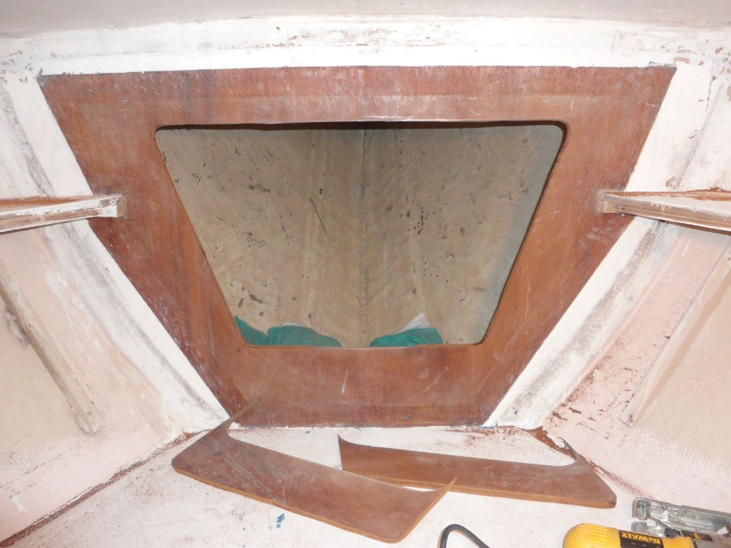

Sorry about the delay. This is under the bow. The line where the shelf used to be is evident. There's also a section where 2 rectangular sections of ply were removed.
Will be grinding this down until it can take whatever it's called to put in new ply. Have to do a template for that ... I would have come in from above, but... I didn't. Sorry! I do have a bunch of those expanding bars that unscrew and are usually used for pull-ups in a doorway. Thought that might work O.K.
I think I need to clean up the ragged ares of where the glass has been "cut."
Should i reuse the fiberglass ceiling I removed once the ply is strongly affixed?

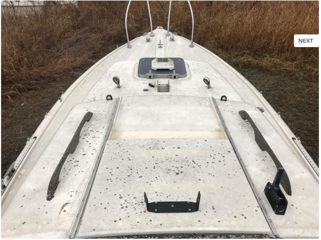

view from the ground
a bit worried about the obvious metallic stain from that seam...

Have had way too much to do besides working on boat. Pictures of dry fit and roller furling; it has a bend in it that looks inoperable? I have never used roller furling, and am pretty sure I will get rid of it and just have simple hank on stays.
Re: Nordica 20'
You might be able to bend it back but I don't know if you can trust it not to break later at the bend. You could try to replace just the lower tube if one is available and it's not corroded in place. I don't recall if you said how much sailing experience you have but if not much you may want to keep the furler until you try it out. You probably already know this but for others who might not, hank-ons are more efficient if you always have the right size sail up for the wind conditions but on average may not be as you frequently carry too much or too little sail for the conditions out of a reluctance to go forward for what might prove a temporary wind change that causes you to frequently change back and forth. They are simpler in amount of gear but are far less simpler to use in changing winds in rough seas and mean you need to carry three jibs at a minimum and maybe four to cover all wind strengths. But a furler needs to be top quality and the installation perfect in order to avoid common problems and the headstay replaced now and then since it can't easily be inspected. If you're an athletic sailor with the right number of jibs then maybe hank-on is the right choice for you.
