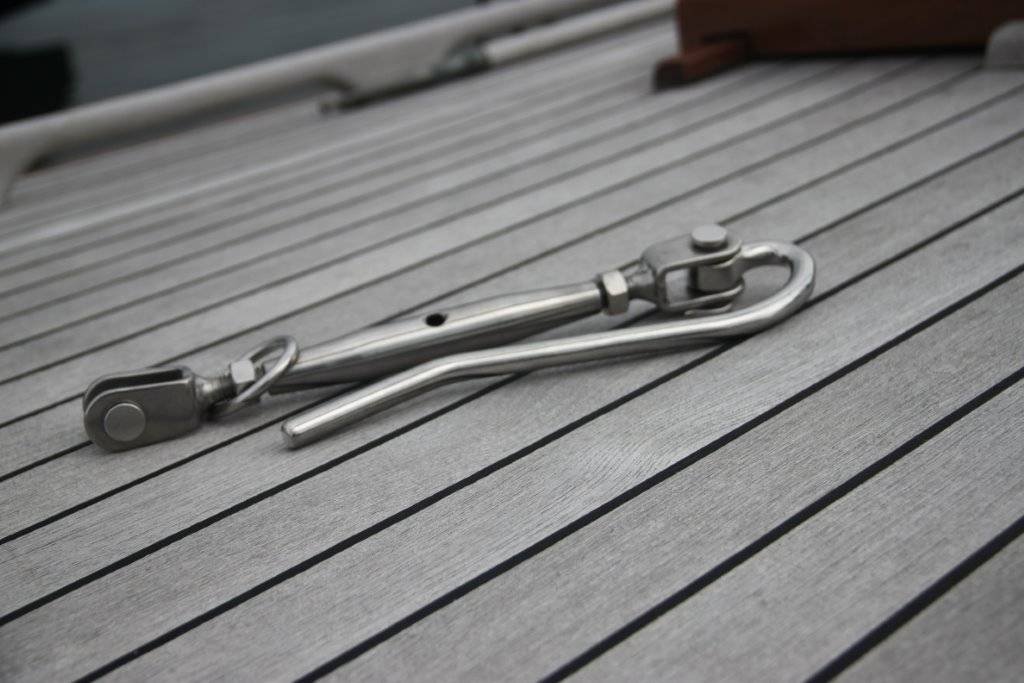

My Final Solution
Hey, as I promised, my follow up to this on what I’ve decided to do for a removable inner stay solution.
First, to address why I don’t have intermediate shrouds, I had a discussion with one of the members of Plastic Classic. The CD 30C has an inner stay that terminates about 4’ down from the top of the mast, meaning that the backstay is assuming the role of counteracting the force of the inner stay. Pretty simple.
For the lever, I’m going with a releasable lever, as shown here:
It’s affordable and if I keep the loading on the staysail low, it’s a functional solution to my objective.
Thanks again to the two replies, never heard of a “Highfield lever” before, sometimes it’s just a matter of vernacular to get on the right track!

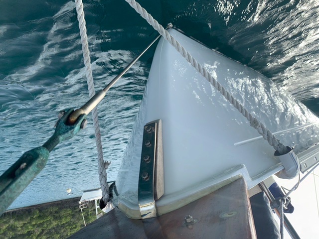

I’m getting ready to install an inner forestry as well. I’m not sure I want a complex lever though; it looks like a good place to clamp your finger in

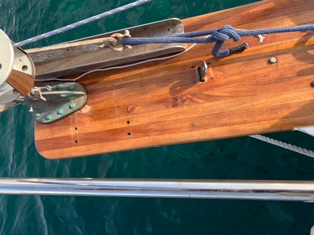

I have a chainplate that passes through my bowsprit and through-bolts into the bow.

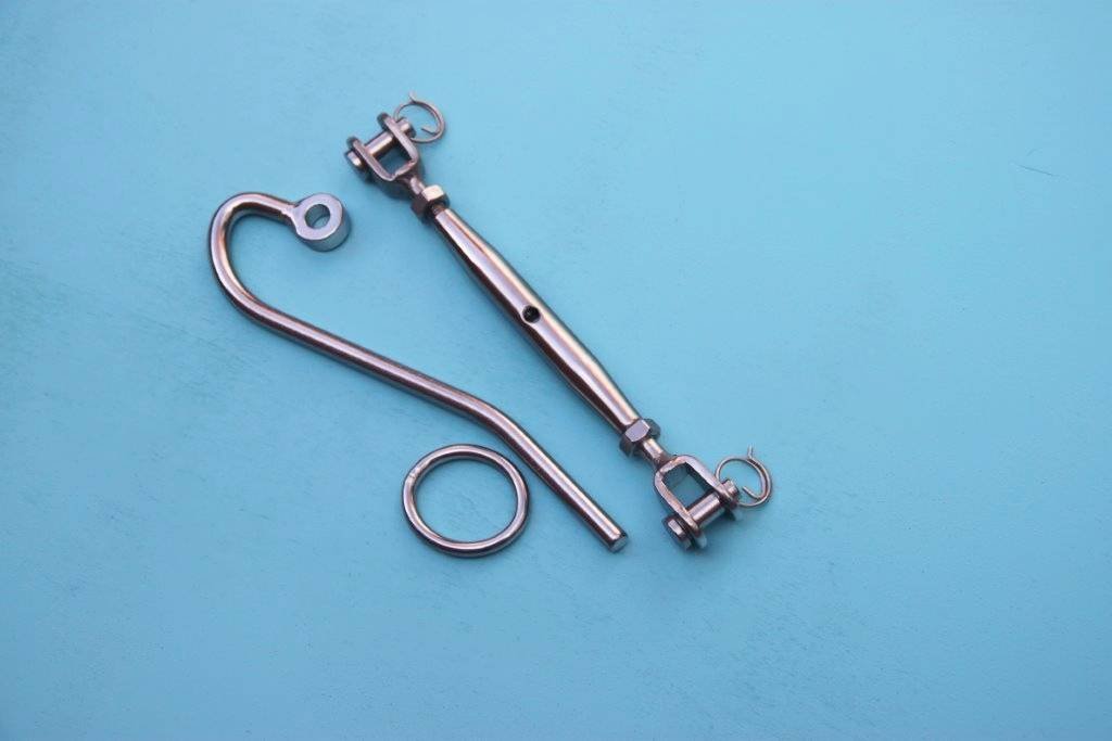

Im thinking about just having a short piece of 1/4” 1x19 cable with swageless fittings on the ends and a toggle between the chainplate and first fitting. The turnbuckle would connect into the other end. Maybe that’s an expensive solution or just go with some smaller crimped wire like shown in Atom’s video.

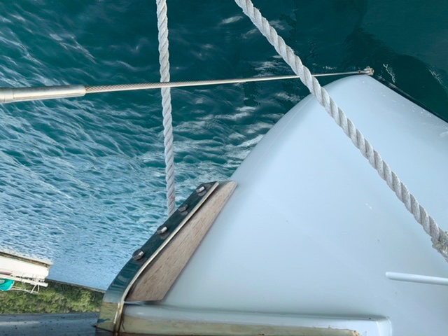

Here’s some pictures of my deck mounting location
A Selden O-Fitting will be installed approximately 18” below the mast head.
I couldn’t find the fitting anywhere in the US so had to have it shipped from the UK. The shipping cost was about 20 US to the Caribbean via Royal Mail.
The fit wasn’t exact but close enough to “shape it” into place using a small piece of 2 x 4.
