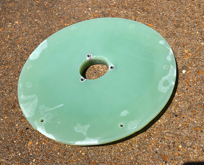

Great idea to use 1/4 G10 board ! That will be much easier to shape and work with and I'll bet plenty strong. I may just go ahead and get that going because ever since I got the 10' Beckson port and noticed it flexes a bit I assume it's probably going to leak.

I've made the new lid with the 1/4' g10, and reinforced it with some 1/2' I had laying around, so this lid will never flex when crawling over the v-berth on your knees. I've chosen to use a standard stainless water deckfill fitting, that'll go into the hole in the middle. I think this will solve my fears of the 8' (10' outer diameter) beckson port leaking. This thing is bomb proof.

Here's what my tank looks like right now, before bedding the lid.
