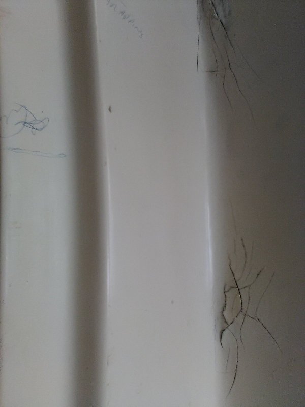

Here is a photo. There are four of these, two on each side of the slot where the bulkhead fits. It appears that something sharp is pushing through the roof.
Re: Bristol 24 - repairing the arch under the deck stepped mast
Can you give us more details of what you are trying to do exactly? It sounds like you want to repair the mast support beam because it is visibly sagging on the inside? and the deck is sagging also? Were you planning to leave the deck alone and cut the fiberglass liner and support beam from inside that looks like it is built into the liner? If you do need to cut out the liner and beam from below to see what you have then at that point you can post photos and it will be clearer how to rebuild it stronger.
Please bear with me until I get better pictures. I will be down to the yard hopefully later this week and I'll post these and a better explanation of what I am trying to do.
