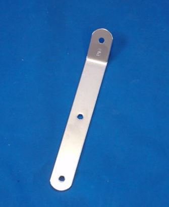

So now that I have them out, I'm considering alternate re-installations. Many of the later model O'Day Rhodes 19s have a shorter upside-down 'T' chainplate that is through bolted on either side of the 'T' and the Stuart Rhodes 19s are straight chainplates with 2 through bolts.
New style chainplates for Stuart Rhodes

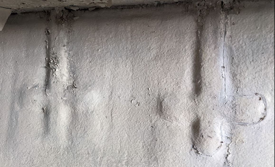

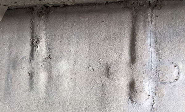

The old chainplates buried in glass

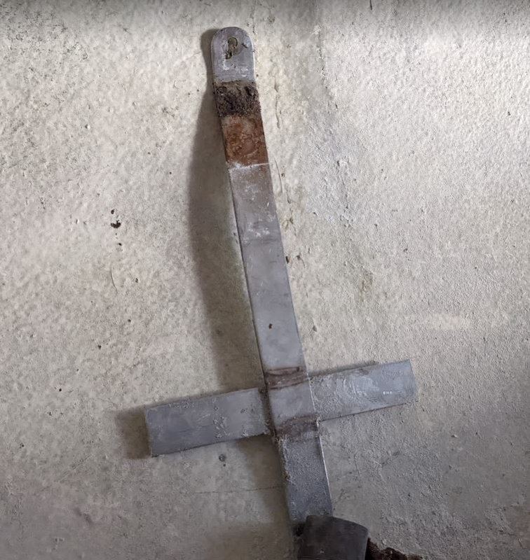

Time for replacement

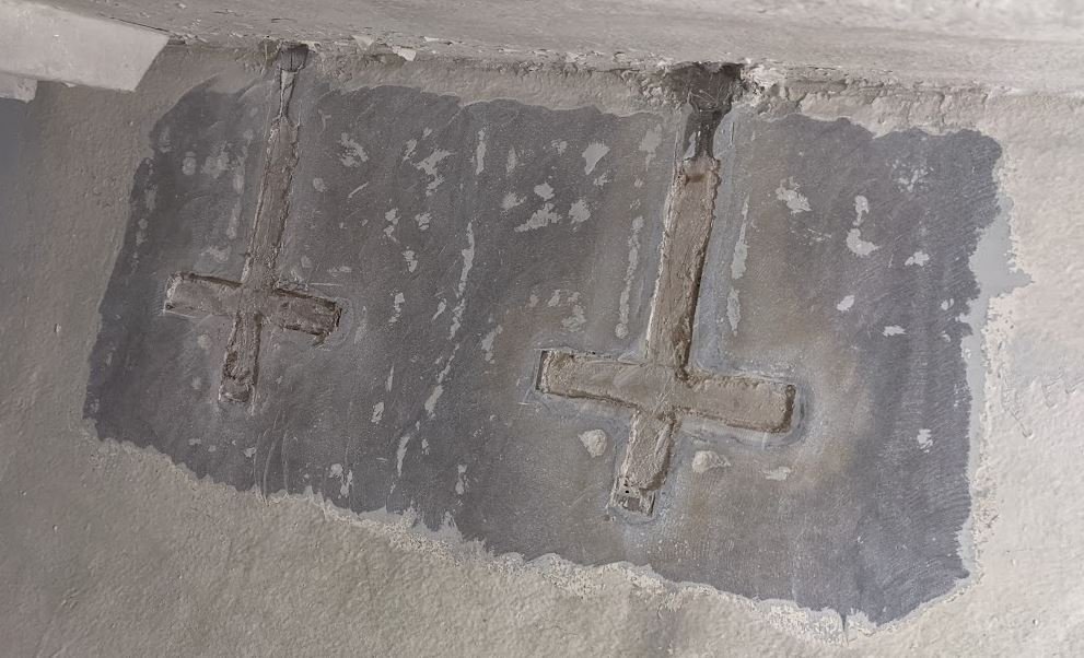

Ground out
Ground out
