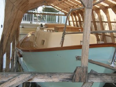

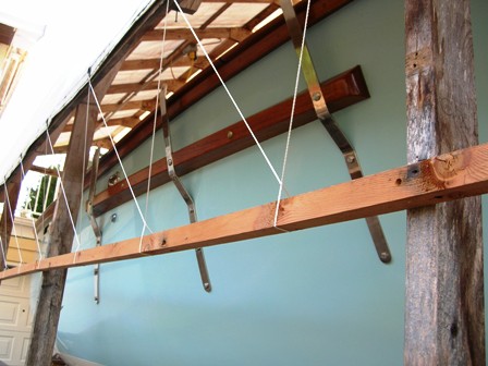

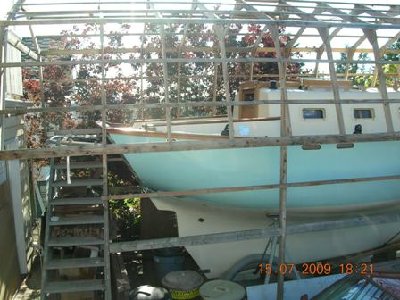

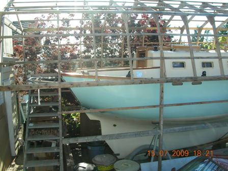

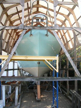

Here's a few pics of a shelter I built many years ago. Yes, it's just a tarp-cover to shelter from the elements. Open at both ends, the tarp comes down to cap-rail level at the sides. It's still protecting the boat year round.
Admittedly we do not get as much bad weather many of you experience on the east side and other parts of the USA and Canada but, occasionally, we will get a tough winter here in the NW and I've seen over a foot of wet snow on this structure a number of times some winters.
I made up the 1x4 arch frames with the aid of a jig for uniformity cutting all the rebates for the 1 x 2 stringers prior to assembly. They are nailed and glued together at the joins using 1/4" plywood plates on each side. The frames are at 24" spacing. This hip-roof is supported on 8'6" 2x4 posts that make up the lower framework with no diagonal bracing on the sides. Actually, the whole structure is mounted on 3" casters allowing me to move it out of the way whenever necessary.
This shelter is located on the north side of my #2 garage (workshop), There's a protective hedge along the west side and the south end is partially protected by the garage. There is a glass panel in the sun-deck railing preventing most wind from that direction. The prevailing winds come from SW and around to the NW. Rarely do we get wind from N, E. or SE. You'll notice the tarp is only laced down with "lineman's nylon pull cord". It has never come undone or broken, even in the occasional gales we have here.
I'm hoping splash day will occur in the spring of 2011 ... I will then dismantle it for scrap or firewood but, I shall sell the 12 y.o. tarp. It is still in very good condition and cleans up well with a little detergent wash every spring.
