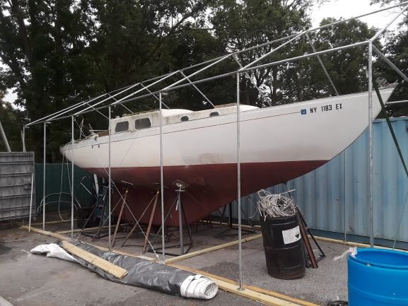

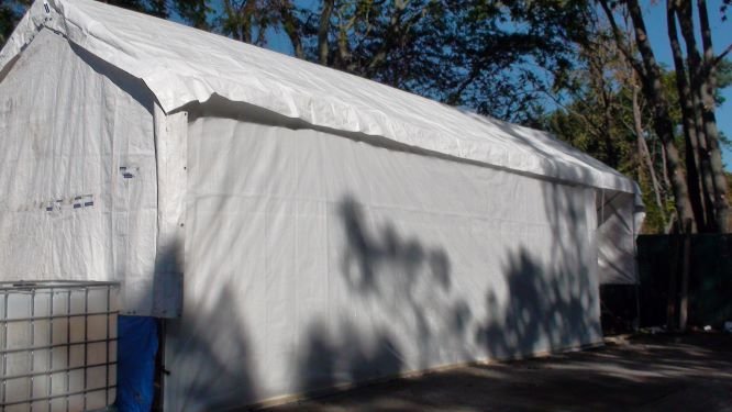

Here was my solution, buy the parts to the size you need, buy the tarps.. this one has been in use for the last two years.
Summer I take the sides off. I used a kerosine heater in the days i work on it.. it get to hot to fast so need a heater with thermostat
You cross brace the ends and in the middle on both sides, I used ratchet straps from HD, It came through hurricane Sandy with little to no damage, couple ripped corners. Also I had to drive 12" spikes in the asphalt 4 to a side.

That looks like a practical and inexpensive solution compared to my more permanent but expensive, metal roofed RV car ports. Can you tell us some of the components such as tubing type and dimensions and which tarps you used. It looks fairly easy to disassemble to store or relocate when needed.

Jealous of the ability to work on a stable, shaded boat that you can walk all around and get to every bit and piece of, even poke holes in it without springing leaks... :)
