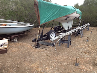

Well, I've come to realization that I need a covered/enclosed space to restore my boat. Working out in the weather is just a bit problematic. Condensation and rain find their way into the bilge and I can't keep the hull dried out. I've been using tarps with straps to keep her covered currently but that's a pain. It takes too long at the end of the day to recover and the tarps just age and fray in the sun.
The boat is in the hills just 5 miles inland to coastal California. I don't have to worry about snow. Wind does whip up around here, though. We get plenty of coastal fog and morning condensation. Sometimes, we get a fair share of rain.
Currently, the boat is on a trailer next to a small shop that I rent on a little property. The shop is 20'x15' and has 110v, wood burning stove, a sink, toilet and even a shower. For the last 7 years, I've used the shop to fix up some old trucks and motorcycles. I've cleared that all out and am trying to make my own wood shop/boat shop. The land lady has given me the okay to put a "car tent" over the boat...I don't think it will to much of a stretch to put up a bow shed.
My boat is 32.5'x6.5' and the bow sits 9' from the ground. The stern is 7' from the ground. The trailer, wheel to wheel, is 8' wide.
The space is somewhat limited but I could build a 12'x36' bow shed and, perhaps 14' tall. I'm 6' tall. I suppose I could use 14'-16' strapping.
I might have room for a 14' wide shed but that would be pushing it. The lot is, also, on a slight slope. The rear of the lot is also angled and I was thinking about this round end shed to maximize space.... Thoughts?
Also, talk to me about tarps on the dirt floor, etc...

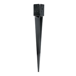

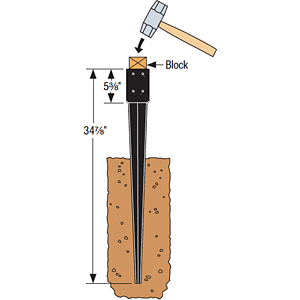

What do you guys think of this Simpson EZ Spike to anchor in some 4x4s and tie the bow shed into? My main concern would be wind coming up through the hills. Would this be adequate enough? Perhaps this with some cable/anchors, also?
Perhaps, these placed every 8 foot on the sides. These spikes are about $16 each at Home Depot. I would be looking at 4-5 on each side.
I just thisk this would save a lot of time than digging post holes and setting posts into concrete. This is supposed to be a temporary shed for me.
Perhaps, a pressure treated 4x4 in the ground with no cement would be fine, too?
- ezspike-uninstalled.jpg (3.88 KiB) Viewed 36235 times
- This goes 29" into the ground.
- 201a-2013.gif (12.45 KiB) Viewed 36235 times

I just used a post hole digger and sank PT 4x4s into the ground as deep as I could get them (~4 feet). You can get a post hole digger for the price of 2 spikes. Those spikes may work if you don't hit any rocks but the bows will try to push out (especially if you get a snow load), so having a stable base is a good thing.
Re: I think I may build a Stimson Bow Shed
The stimson plans call for 5/4 x 2 1/2" stakes into the ground, every 4 feet. I guess those would hold as well as these EZ spikes.
I do own a post hole digger...but the ground around here is CLAY. I had to rent a gas powered auger to dig the holes for my backyard fence.
How well will stakes 2feet into the ground hold for wind?

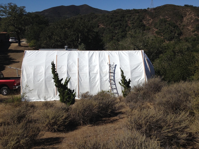

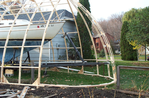

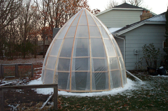

I put this up a year ago but still haven't done much work inside... new business, new kids...life!
Anyways, not the best I've seen but it'll work. I didn't shrink the wrap... not sure it needs to be done. It sure needs ventilation, though.
I'd add more build photos but having to resize the images is a pain that I just don't have time to endure...
