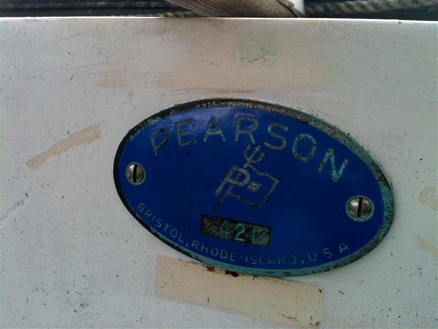

Hull #421 was built in 1963, the 2nd year of production for the Ensign.

I thought the date and # were out of synch also. I have 1965 #1387. Are you sure it is #421 and not 1421 which may be closer to 1972. If not ant 421 is correct I agree with the previous poster (#1 wow).

As to the question of provenance, since it's a lingering question I'll post the picture of the hull # plate on the after-most part of the cockpit, just under the tiller.
