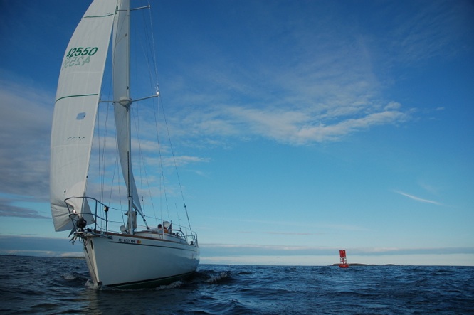

I don't know how the (racing?) sail numbers work, but searching "Spartina" with the sail number in that last photo comes up with the boat type listed as "Custom."
Why does the backstay go to that boomkin instead of the transom?
Why does it have running backstays at all? (it looks like the boom doesn't conflict, or at least it almost-doesn't)
I agree. I start seeing parts of this boat that I like and then run into parts that I can't make sense of.
It almost seems like a boat designed by a committee.
But I guess now is a good time to remind myself that my taste are outside the norm.
Can't see the top of the mast to know if it's fractionally rigged or not - the running backstays could be because it is (forestay tension and proper support for the rig in heavy air).
The boomkin is surprising - but presumably there is some reason, not immediately apparent, for it's existence...
Perhaps the boomkin is there to enable a mainsail with a monstrous roach. Or its there as an aesthetic choice.
Only reasons I can think of. Otherwise, its pointless.
I actually do like the boat. Its interesting, quite different. From the placement of the mast, I suspect it may be a fractionally rigged sailboat. This also caused me to think the boomkin for aesthetics because normally, you do not need a bowsprit for a fractionally rigged sailboat (not as common like for masthead rigged).
I'm 99.99 % certain its custom. I'm a hopeless boat nut and I have never seen something like this boat so that's really something...
Maybe the owner likes to stand right on the cockpit seats at the aft end of the cockpit. Having the backstay at the normal place... lots of head boinking with the backstay. So a boomkin is added to keep the backstay farther away.
A weird though, I know but trying to think of why the boomkin is there.
I agree w/ case that the boomkin is probably there to keep the backstay off the mainsail's roach. As for the runners, they were typically used on fractionally rigged racers, in addition to the fixed backstay, to help keep the luff of the headsail taut.

There is an inner forestay and judging from the almost parallel topping lift and back stay then this is a TALL rig. So possibly the boom kin is for the roach and the running backs are for the stay sail. Sounds like a lot of clap-trap for a little gain if that is the case.
So maybe clap-trap was not the proper word to use. To me a boomkin is a compendium of stresses that include compression as well as tensile to fight each other to hold the rig up. I sailed on a sandbagger once with a huge boomkin and an even bigger bowsprit. Sailing that boat was a whole lot of fun feeling like I was living on the edge. In a discussion with the owner, he told me that he had rebuilt the boomkin twice in 20 years and the bowsprit about 5 years earlier. He added that the stresses of the rig was very hard on the boat. Also, running backs are another complication that when operated properly by people that know what they are doing, is poetry in motion. It is also an invitation to disaster for people that do not fully understand the stresses involved and the potential consequences of bad timing. Maybe a better term would have been "complication."

I agree with Rachel. Rigging questions aside, I really like the looks of the boat aesthetically - except the deadlights. It looks like a comfy and secure cockpit with the wrap around coamings, and I like how the coaming cap is incorporated with the eye brows. With no forecabin trunk, it's got a working foredeck that rivals Bolero's.
It's got a kind of, I don't know, "stout" ruggedness to it, reminiscent to some of the Pacific Seacrafts - but it also has some nice curves too. Put a couple of bronze portals on each side and it would really look sharp. But as they say, opinions... everybody's got one. :)
