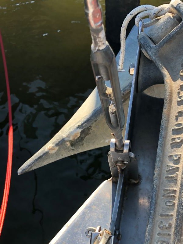

This is a picture of the forestay integrated with the anchor roller. Wondering if this is strong enough to drill out from 7/16th to 1/2 inch. Not sure if the top of the mast would be able to accept a 1/4 inch wire.
Craig

If it were me I'd prefer to have 1/4 all around but that is not essential. You could go with 1/4 headstay and 7/32 everywhere else if that was easier for you to get clevis pins to fit existing hardware. 3/16 is undersize for what I would want though. Chainplate clevis pin holes can be drilled out only if there is enough shoulder to allow it without creating a weak point. But no need to do that with your stemhead fitting because a 1/4" wire sta-lok stud is offered for 7/16 turnbuckle with 7/16 clevis pin. Here's the rigging supplier I use:
https://www.riggingandhardware.com/c-11 ... studs.aspx

I agree and would like to do 1/4 all around. I'll have to check the upper and lowers to see what size clevis pins they are using on the mast connection and if a swage fitting for their sizes can accommodate a 1/4in wire.
Craig
