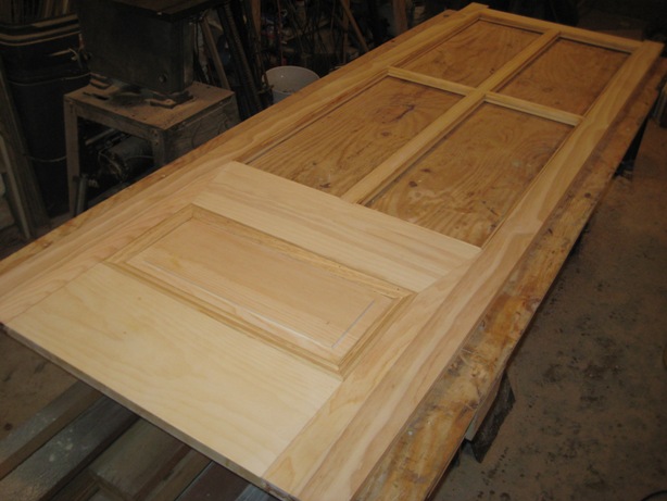

Making raised panels is relatively easy and traditional. This 1850's style panel is flat with a raised area in the middle. The perimeter is decorated with added mouldings. It's captured within the stiles and rails. This panel and trim matches other work in my house. However, the moulding was too much like work to grind a bit for. I found that a standard white pine profile available at the Despot could be cut down for a near match to the original material. A simple jig controls the bandsaw blade against damage from the metal guide (3648).
The panel complete, stock moulding, and original material (3650).
The door is 8'-2 tall and 2'-10 wide, will be mounted on the interior and swing in. The muntins are beaded and mimic the sash of the gib door. (3652)
