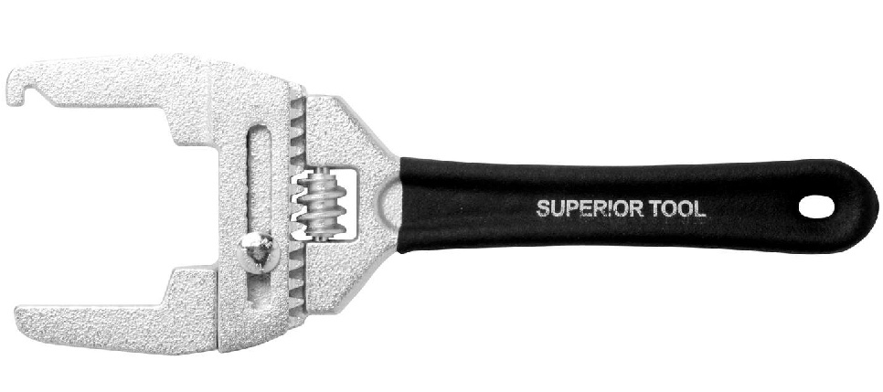

Re: Favorite Odd Tools - 2 Strainer Basket Wrenchs for Stuffing Box Adjustments
This looks like an older thread, but I’m going to go ahead and contribute.
A couple tools popped in my mind when I start looking through this thread.
I have two of the strainer basket wrenches, that are in the plumbing section of hardware stores.
They are thinner than big crescent wrenchs or smooth jaw pipe wrenchs so they pass by each other with ease.
Also they have a shorter handle that fits smaller tool boxes.
I found they are great for adjusting stuffing boxes, especially for breaking or retightening the nuts.
You can put the handles closer together so you can squeeze with two hands.
There is a thumb screw on the wrenches I have that allow you to lock down the opening size so it isn’t loose or prone to changing the opening if you bump the adjuster.
…but I always follow up to check by snugging the nut and locknut with two crescent wrenches in the end.
I’ve intended to purchase shorter spanners or cut down a pair or crescents or cut some stuffing box tools from plates steel, but in the end but somehow this doesn’t make it to the top of my list.
I always end up using these.
They’re relatively inexpensive and always available in the hardware/big box stores.
If you’re in a bind and need to buy two wrenches quickly these are a hit!
