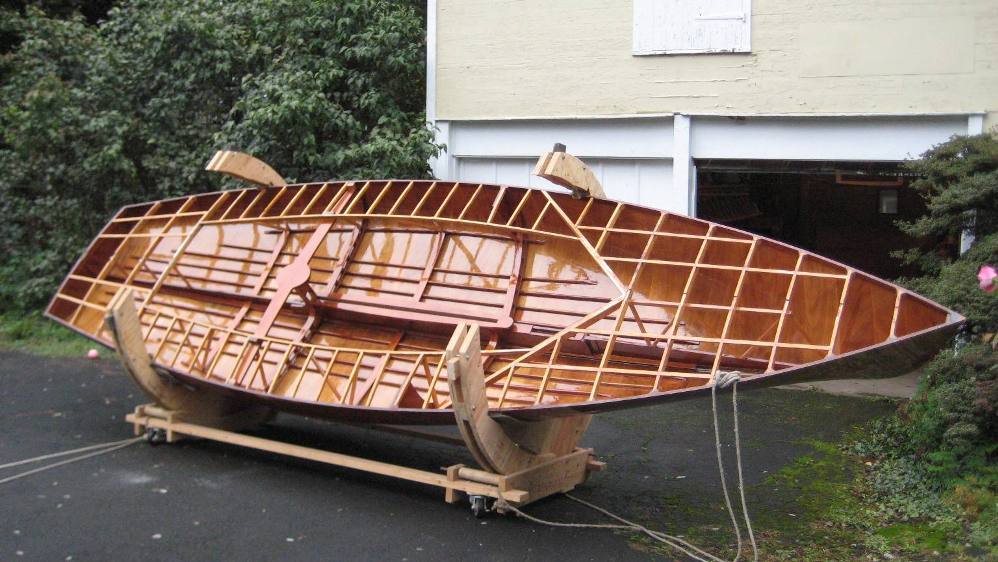

The game at hand is to prepare the interior of FD US 29 for several coats of marine varnish. Soon, I hope, install hardware that will be an inconvenient reach after the deck goes on.
Before starting sanding out the epoxy.

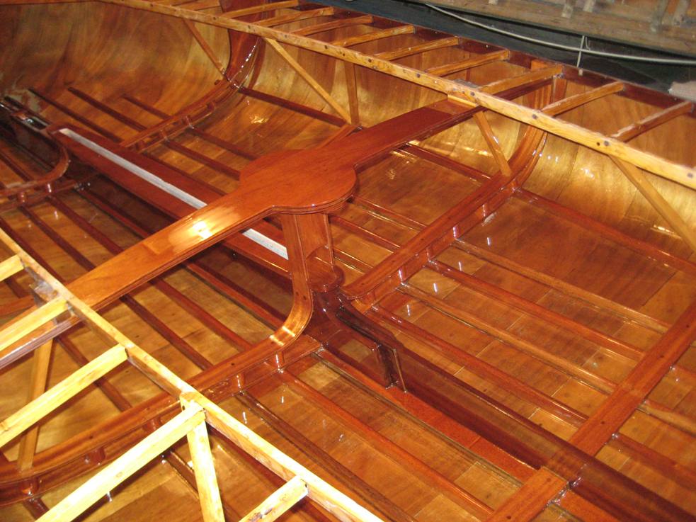

I finished sanding out the boat and have applied the first of (min) 4 coats of Pettit Flagship 2015.
I used ordinary dust-free exam gloves on my strong hand and got maybe 2 hours out of each glove.
I found that the Wetordry 220 would last longer cut into 1/8ths, means that the piece in your hand is folded only once and never grit-to-grit.
I took Zach's idea and made a single spruce 'finger', approx 8" x 5/8" x 5/8" ground to a long gentle curve on part of one face; wrap the 1/8 sheet around it longways and hold it with one hand's finger while sanding with the other hand. The curved end served to ensure that a reasonable area (fingertip size) would be in contact with the work without having to be slavish about what angle the 'finger' was being stroked at. The spruce is soft enough so that I did not bother with a cloth pad.
Between 16 and 20 hours to sand the epoxy and 2 1/2 hours to varnish. I sincerely hope the varnish will sand out more quickly; the 'dits' and drips are much smaller. I bought the Despot's 'best' brushes and used the 2 1/2" angled one and a 2" foam applicator to get under the frames.
I got pretty decent results, I think, but not anywhere as good as I want the last coat. There's plenty of dust in the barn with no possibility of getting it clean enough, no possiblity of tenting the work in plastic (I'd suffocate in heat and fumes for one, and there's no room). It's also hard to keep a wet edge starting on one side, going to the other end and coming back on the other side; hard enough keeping a wet edge on one side, varnishing in 20" or so sections from centerline to sheer.
About that Pettit varnish; it's $130 at West Marine. WM has a price beater guarantee. Both Defender and Jamestown have the stuff for $97-100 w/delivery, so I should/will be getting a refund, so says their customer service guy.
As for sanding outside corners, if they're relatively sharp, I'm careful to avoid sanding them at all until last. It's wonderfully easy to sand through or to end up with a much thinner coating on a vulnerable place. I sand the faces, sneaking up to the corner, and then hit the corner with one or two swipes. It is important to have something of a radius on a corner, of course. If it's a gentle large radius then it's important to work out a stroke, such as Zach's, to avoid sanding in flat spots. I try to do as my grandfather, a USN Captain, taught me when I was about 6 (who would argue with a Captain?): Using a flat tool, like a file or sanding block, start with the leading edge, working across the curve, stroke and sweep your hand down, finishing the stroke with the heel of the tool. This means that the tool is never touching the work in one place. The other stroke I use is to do circular patterns working along the curve.
