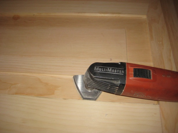

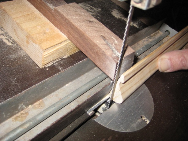

Those of you who have Fein Multimasters or one of the knockoffs may have found that the normal triangular pad is too big to get into places and that the little finger is too easily damaged to be of much use. Working on a new storm door this weekend, I found that the depressed area on the panel was too narrow, so I took a pad which had a damaged corner and simply ground it off, and then trimmed the paper with a Stanley knife. Piece of cake to do and certainly more robust than the finger. (3646 and 3647)

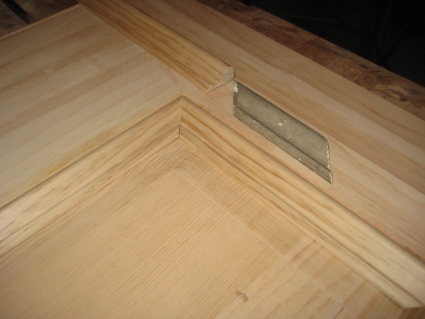

Making raised panels is relatively easy and traditional. This 1850's style panel is flat with a raised area in the middle. The perimeter is decorated with added mouldings. It's captured within the stiles and rails. This panel and trim matches other work in my house. However, the moulding was too much like work to grind a bit for. I found that a standard white pine profile available at the Despot could be cut down for a near match to the original material. A simple jig controls the bandsaw blade against damage from the metal guide (3648).
The panel complete, stock moulding, and original material (3650).

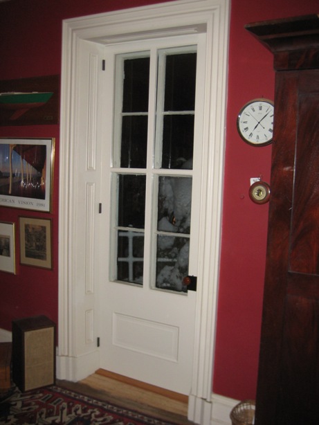

The door is 8'-2 tall and 2'-10 wide, will be mounted on the interior and swing in. The muntins are beaded and mimic the sash of the gib door. (3652)

What a great idea for a mod to a Fein triangular sanding pad. Now why didn't I think of that? Even with plenty of room, and trying to hold the tool flat, I always seem to wear the point away.
Thanks for the idea.

The best orientation of the pad with respect to the tool has everything to do with the work, the comfort of your hands, and visibility, and less to do with symmetry. I often rotate the pad to suit the problem, which is a pain since you have to remove the paper to access the bolt on this old model. I've thought of punching a hole in the center of the paper to access the bolt since the center doesn't sand anything anyway.
A Fein's paper and triangular pad tends to wear more at the tips than the edges. And the tips of the pad are more often damaged by the heat of sanding. I therefore routinely try to use the tool flat and along one of the edges of the pad rather than the tips, so I did most of the sanding here with the one remaining complete edge. Removing the one damaged tip on an old pad left me with the two others. Removing the minimum of the pad left me with the largest possible area of paper attachment.
Bottom line here is that the reshaping of a Fein's pad and paper is pretty easy and potentially useful. I used one of my 12" disc sanders, which have 80 grit paper, and ground the same angle that the factory edges have to keep the aluminum backer away from the work.

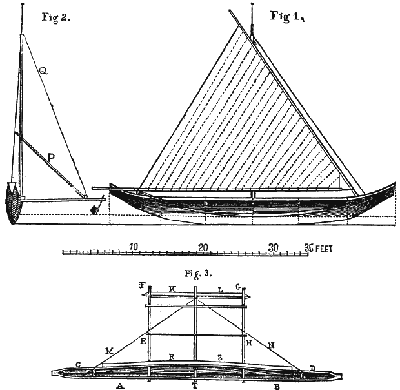

Quetzalsailor wrote:It's symmetrical like a proa.
Ha! I like it!
Re: A Fein modification and a simple jig
Symmetrical in plan, and longitudinal elevation, not in section.
http://www.thecheappages.com/proa/alden ... _proa.html

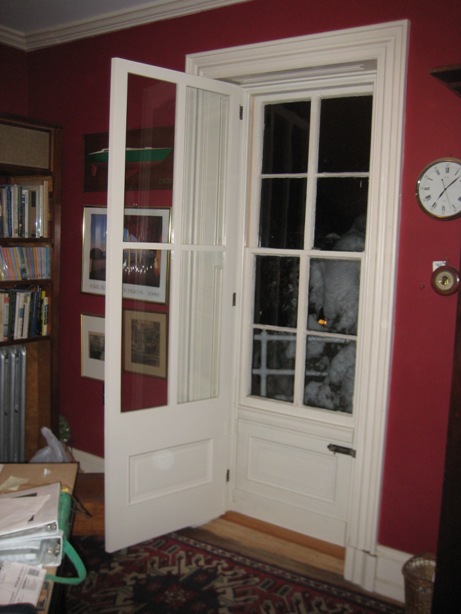

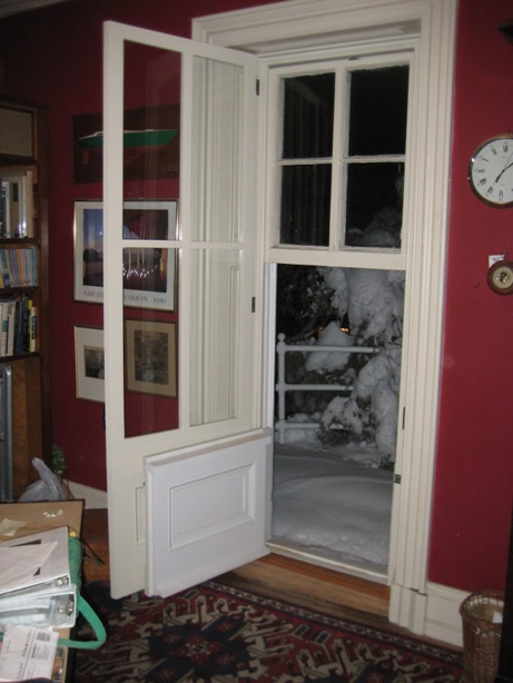

Finished the door this morning as the storm stopped Philly with 12 or more inches of wet, packable snow. Rumor has it that there's a big stom a'comin' next week, too.
Unfortunately, not a single step beyond what was discussed earlier was amenable to jigging. Roughed out the hinge mortices with a router, but the antique cast iron 'open' hinges are tapered in thickness so hand finishing was required. Except for the panels and the glass, nothing is quite square, head and sill are sloping, the threshold is tapered, the frame opening and door edges are angled to match the splayed paneled window jambs. Modified the antique cast iron rim latch so that the Bennington knob is only on the inside and made a new keeper/strike out of fiberglass since an antique would not fit the narrow jamb.
Storm door closed.
Storm door open.
Storm door and gib door open. This is the same gib door that I presented last winter with the problem of cleaning up the rabbets for the parting strips.

I can't believe that the molding is the same as the six panel interior doors I am making for my house! I cut and milled the lumber from an 80' ash tree on my property. The molding is mahogany with ash and cherry panels. The stiles and rails are joined with "floating" tenons. (double mortises)
