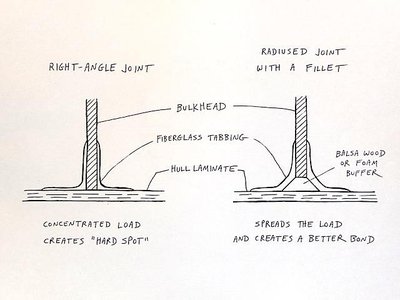

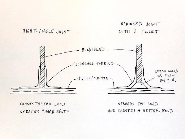

Re: Brand Name of Foam
The trapezoid shape makes for a nice detail, but I doubt it does anything to improve the bond. Bond is adhesion to stuff. Your prep work on the hull and plywood, and your choice of resin are what effect that. If anything, your cloth will like a rounded inside corner most of all for bending around. So the trapezoid will still need a little thickened epoxy. And even thought the angles are better, it has 2 corners. All the foam needs to accomplish is to keep the plywood off the hull before and during tabbing to avoid hard spots. If you want it to add a cosmetic detail that you like then go for it. Everyone has there own way of doing things. But many techniques, though they look cool and sound good don't really make for a stronger or better anything.
Hmmm. I have my doubts about the use of foam between the hull and the edge of a bulkhead actually working to 'reduce hard spots'. I think what you're really trying to do is to keep water from wicking into the end grain of the plywood. In the good old days, when our old boats were built, the tabbing was laid up in polyester resin and the end grain was seldom coated out. Polyester resin does not really stick well to wood, especially given the wood's coming and going with moisture content. Now, most of us probably do our repair work with epoxy resins and we coat out the end grain. Thus the debonding problem and the rotting due to trapped moisture in wood is much reduced. An adequate thickness of tabbing, intended to transfer the strength of the plywood (in tension, compression merely requires the plywood to stay put) will be more than stiff enough to cause any hard spot we'd fear. None of us intend that the tabbing is elastic. None of us are engineering the bottom panels to 'float' free of the frames as is sometimes done in ocean-capable power boats. A nice, stiff assembly of tabbing actually spreads the 'hard spot' out into a hard area, much wider. Additionally, tabbing fails in shear, as debonding between the wood and the tabbing, or it fails in 'peeling' the cold bond off of the hull. While adding a nice tapered bit of foam allows for easier, gentler layup of tabbing, it does poorly for the peeling since the distance and flexure in the tabbing is longer. I think a better solution would be to coat out the plywood in epoxy, fit it as neatly or haphazardly as you might, then use the epoxy to fillet between the plywood and the hull - taking care to fill the errant gap. Then the fillets do something good structurally as well as to form an easier layup.
I disagree. The hull will move and any part of the bulkhead edge that touches the hull will be a hard spot you don't want. By using a spacer of foam the tabbing takes the entire load spread over a much larger area evenly. The edge of the plywood bulkhead does not and cannot touch the hull.
If the bulkhead was a perfect fit to the hull there would be a lesser chance of a localized hard spot, but one the entire area of the bulkhead edge would exist. And that is next to impossible to do anyway as the hull has high spots and low spots because of the roving used in the original layup.
It doesn't have to be foam. Morris uses spacers and after one side is tabbed the spacers are removed before tabbing the other side. Same result when done - the hard bulkhead edge is kept away from the hull.
Interesting thread. I tend to agree on it being a good idea to space the edge of the bulkhead away from the hull and then let the wide tabbing transfer the force/load to the hull and not the edge of the bulkhead.
I, too, don't see where the filleting needs to have particular strength. I thought it was to make for a gradual transition, which the cloth/glass likes. I have wondered if it matters if the cloth adheres to that section (i.e., if it did not adhere as well to tapered foam as to an epoxy fillet would that matter)?
Hey yawl! Don't dismiss the fillet. If you're using West's filleting additive/filler, or similar, you're creating a structural adhesive. You need not add fiber to it. Plenty of small boats are bonded solely with fillets. Tabbing can be made with single or multiple plies of 'glass; the determinant is how much stress the tabbing is intended to handle. Bulkheads, engine beds and serious stuff require more 'glass than, say, a shelf or a battery box.
Back to bulkheads and hardspots. I'd opine that the hardspots that we see on some hulls are more a function of extended cure over time. The same thing is what causes print through of fabric pattern. I read in Professional BoatBuilder that an old white hull that lived in northern climes and then was moved to the south and painted black would show print through - years later! Other causes of hardspots include the hull simply being structurally too light. My dad observed another boat sailing a parallel course and saw the hull pucker in with every gust. No doubt, his '72 Morgan 27's deck was being lifted with those same gusts! That same Morgan's tabbing at the bulkheads near the mast were peeling off the hull, and the whole hull was bending to open the famous 'Morgan Smile' between hull and keel.
