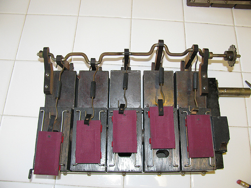

What are the five red dancing cards doing? It looks like they'd be letting off a little steam, but I don't understand the purpose. Very fun to watch, that's for sure!

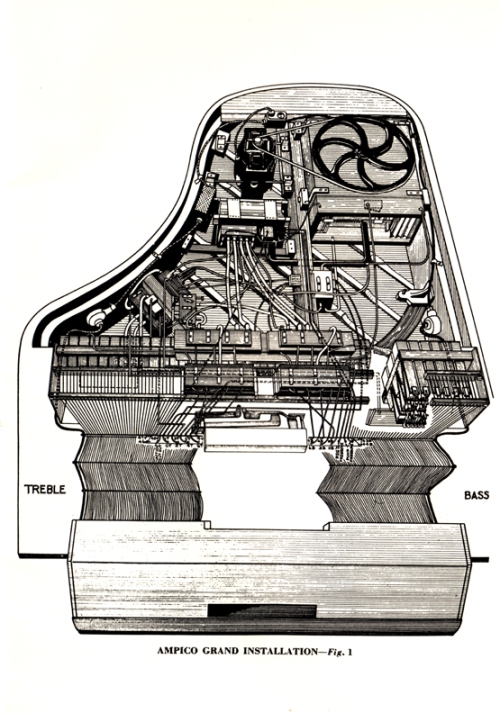

The Ampico (AMerican PIano COmpany) player action is one of several makes which reproduce the playing of the original pianist. The American Piano Company was formed by the merger in about 1912, of Knabe, Chickering, and Mason & Hamlin; they built those three top of the line brands and a whole coterie of lesser, cheaper brands. But you could get an Ampico action in any of them. The rolls are encoded along the edges, those extra holes, which tells the action to raise or lower the amount of vacuum in the Bass and Treble windchests. Thus the key striker pneumatics (bellows) have more or less power to raise the keys harder or softer. Prominent pianists of the day recorded, and approved their recordings(!), for the Ampico, Duo-Art, Welte Mignon, etc.
Here's an idea of the complexity hidden under an otherwise normal grand: The 5 dancing cards are the five slide valve covers controlling air flow through the five pneumatics of the air motor that drives the roll. The crank is a piece of heavy bent wire, formed with 'journals' at 72 degrees. (this one is just beginning to be disassembled; it's not mine)

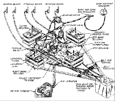

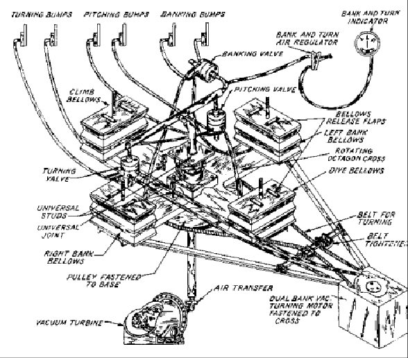

Interestingly, the WW II era Link Trainer, designed to teach instrument airplane flying, was majorly pneumatic in the operation of the cockpit. A very similar air motor rotated the 'plane and bellows set pitch, and bank. Fun for a Sunday morning; gets your mind out of the bilge for a moment.
