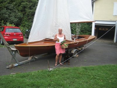

Well, I have not posted on this subject since the winter, but I have not been sitting around. Here she is on Sunday afternoon.
Here are a couple of the Heckrottes and a few of our manias, soon to celebrate our 20th anniversary. Sue's an astonishingly fecund gardener; Kochi, the Coon Hound, is an astonishingly dedicated but unsuccessful squirrel huntress. 20 long, dreary years, as Sue's parents used to quote one of their oldest friends.
We intend to take her to the water this weekend. 11 years since I began restoration (2 years were too hot for working in the barn and two were curtailed by my dad's passing and Hurricane Irene smashing through their house). 19 years almost to the day when she won the 'Mononomac Gremlin' trophy for the worst misadventure suffered by a contestant during the then-annual FD regatta at Lake Monomonac near Rindge NH, on the border between MA and NH. I kicked the tube type self bailer and it broke out of the bottom; we sailed back to land with me kneeling on a life jacket to staunch the reverse drain effect. We found later that, unrelated, a huge strip of veneer was missing off the bottom. 20 years, almost to the day from our wedding on 1 August 1992. 20 years and a week, almost to the day, from when I towed her home from Miami FL, the weekend before our marriage.

It looks like your spring varnishing was a success. I hope you share some pictures of the gang on the water. Congratulations!
Re: Progress
Posted: Tue Jul 31, 2012 11:06 am
by galleywench
Wow, looks fantastic. She'll turn heads for sure!
Are you still on Lake Monomonac? I haven't heard that name in a long time, I surveyed the lake back in the early 90's.
