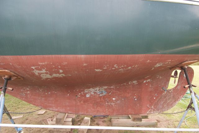

First question: the previous owner was having issues of water in the bilge and had this drain plug installed. is it in the right location? this is an exterior lead keel, and it seems to be hollow fiberglass aft of the lead, wouldn't that be a better location?

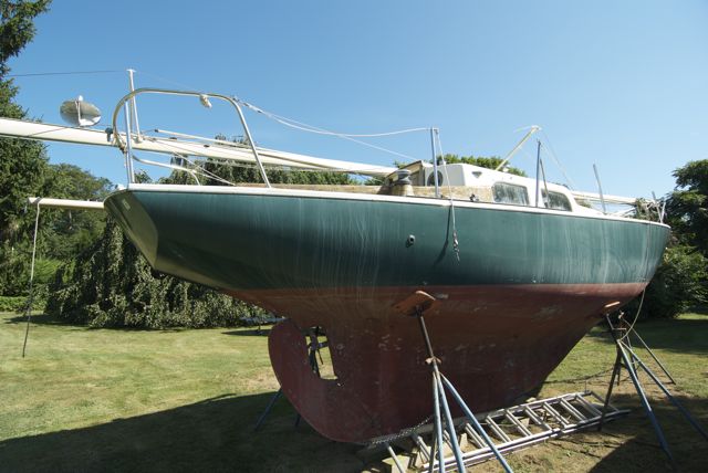

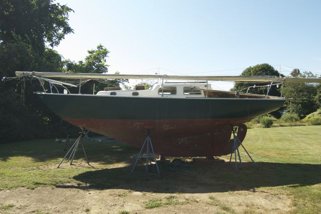

a few pics of hull #345. which has no name at the moment. since these photos, i have taken the mast down, given her a full on scrubbing, removed and patched her lifeline stantions, removed and stripped her coaming and winch blocks, and am trying to setup an appointment to get her shrink-wrapped for the winter.

That's a fine location for the plug. The false keel (area aft) is foam filled. It may be water-filled as well, but unless that's creating other issues for you, I wouldn't sweat it.
Yes, the first pic shows the joint between the ballast keel and the hull. It will move forever. No, it's not a real problem.
(yes, I laid a lot of heavy biax over mine and faired it all to a gnat's ass, but I'm a freak.)
Spend your efforts on the decks.
