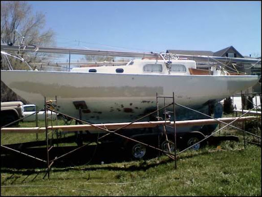

Re: Triton Brass windows
The window frames on my '59 Triton are silver, looks like Aluminum. Is this an early Triton thing, or did someone change the frames?
I knew there would be an inconsistency! :D
I thought that all the early Triton ports (that had frames) were bronze, but if there is any rule it is that no two are alike, it seems. Still, I would be a bit surprised if there were original aluminum ports on a 1959 Triton. Maybe chromed bronze? Or replacements?
Can you post photos?
Definitely not chromed bronze. The opening ports in the main cabin are aluminum but the smaller ones in the head and V-berth are bronze. It's possible they where changed.
