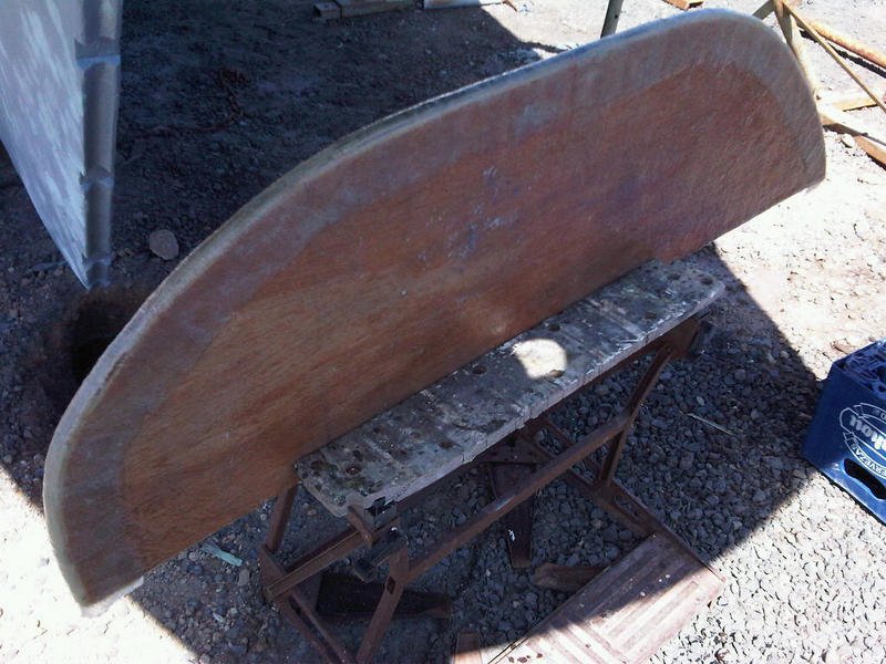

I rebuilt my Triton rudder using two pieces of 3/4 plywood, fiberglass on top and off the shelf stainless pintles and gudgeons while in South Africa in 1996. Bronze was not available and converting to a shoe at that time was too complicated. I know stainless is prone to corrosion underwater but I epoxied them over and they've been good since.

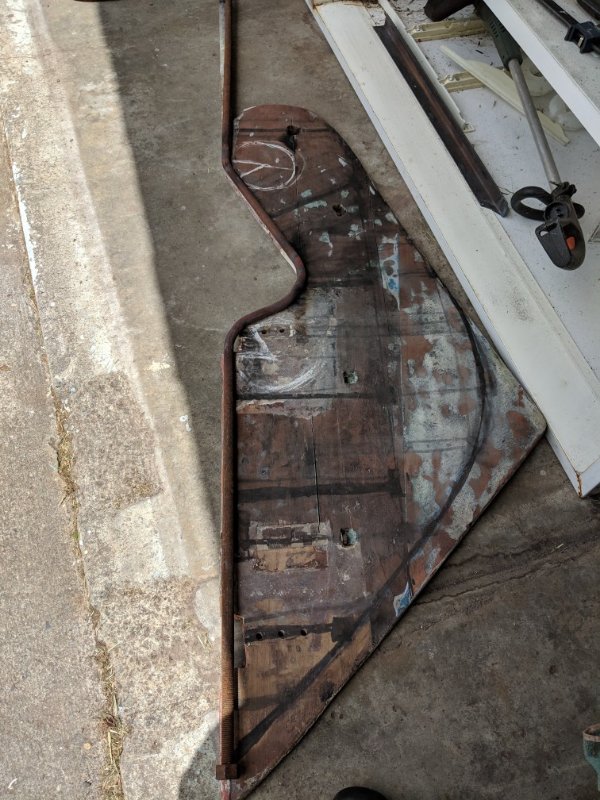

The Triton I'm working on now in our backyard shed has a glass-covered plywood rudder with shoe instead of pintles and full length stainless shaft built by the previous owner about 8 years ago. It is somewhat overbuilt which is good so that you don't have to worry about stainless corrosion reducing the strength for many years to come. It had a lot of bolt heads, nuts and zincs protruding that made keeping the bottom clean difficult so I fared it in and sealed it under epoxy so that there are only slight gradual lumps where the fasteners are. I know it's not ideal to bury hardware and fasteners but the alternatives seemed worse and I haven't had a problem doing this on my own boat.
Here's the photos of the previous owner's work. The last one shows the hardware fared over and you might be able to make out that he added a semi-circle of stainless rod to the rudder shoe to prevent trap and fish net lines entangling in the gap. I have a flat plate on the bottom to do the same on my boat. On my boat I shortened and raised the bottom of the rudder about two inches so when going aground there is less chance of damage.
If you still have an inboard engine then you need a different design more like the original but you can still add a long pin to the lower end and fit a shoe. The Alberg 30 has a shoe and one set of pintles midway, which is good to reduce the loads on the upper and lower ends. If you don't do that then you may need to reinforce the upper end where it passes into the cockpit and have a sturdy bushing there.

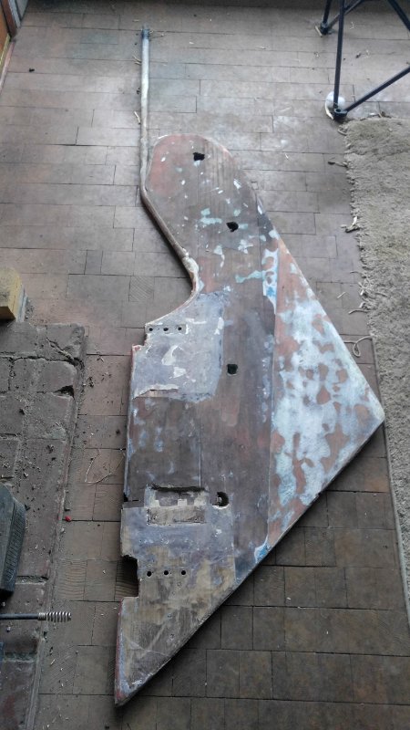

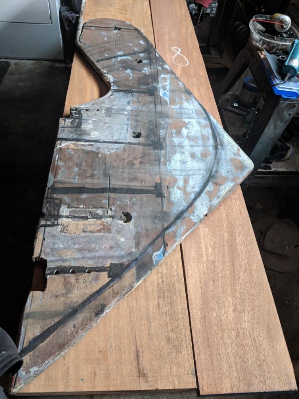

This is the current state of Dragonfly's rudder.
You can see that wood has been replaced under each pintle and on the trailing edge by previous owners.
Ken.

I propose to make a new fiberglass rudder of the same shape but with an internal full length bronze rudder shaft shown by the green tape. The wooden pieces laying on top represent welded on bronze supports. I bought a pipe bender to shape the bronze and plan to build Alberg 30 type pintles and rudder shoe. During layup, the rudder tube will be clamped to a piece of angle iron to guarantee alignment. I have never built a rudder. Any comments appreciated. Here is the proposed layout.

The 'W' shape of the shaft seems really ambitious. To make life a bit simpler, I would forego the the flats inboard on the rudder. But maybe that would be too much of a bend on the shaft, to go almost 90 degrees to head back to the leading edge.

Also, I propose to remove the two inch strip of rudder along the line drawn to protect it from grounding.

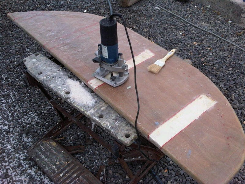

Hi Guys. Solid Mahogany costs the same as plywood at my location, so I decided to make the Triton's rudder core from it. I was wondering if anyone has any idea about how to scarf the boards together. I was going to join the larger board to the full length bronze rudder stock with long carriage bolts and epoxy the rudder tip on with a tongue and grove joint. Finally, I plan to glass it for protection.

Some ideas:
Looking at what you've got there I would think to go tongue and groove *and* also use dowels to maximize use of the width of the mahogany, basically losing none that way.
Back in the day when I worked on surfboards, on ultralight blanks we used to dig out a narrow band of foam alongside & either side of the central stringer and lay fiberglass rope into that to create a sort of an I-beam. This was under the deck & bottom laminates of 4oz cloth.
You could possibly do the same, carving several slots into the mahogany maybe 1/4" or 3/16" deep, and say 5-6 inches either side of your join, lay in the rope and then sand it back smooth prior to glassing, either as the way to do it, or as a way to strengthen it in addition to glue/dowels/tongue and groove.
Or countersink some straps of metal or G-10 on both sides...
Going to be interesting to see how you finally do it. :)

Hey CapnK. Thanks for the suggestions. As for dowels, what do you think about extending three of carriage bolts to go all the way across the rudder? You can see their rough placement indicated by the black marker drawing. I will have to make them out of 3/8 rod since I couldn't find any 21" long.
Re: Rudder Shoe
I bet that'd do the trick too! :) Might be the best way to do it, even.

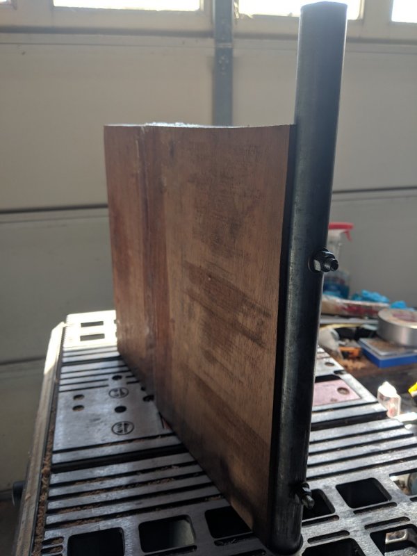

To test the rudder design, I am building a the test/practice rudder and could use some advise. The test rudder is made from two mahogany boards joined by an epoxied tongue and groove joint. The test rudder shaft is made from pipe bolted through both boards. All hardware in the final rudder will be silicon bronze. Should I use these bolts as with the original Triton rudder or do you think external straps welded to the rudder shaft would be stronger?
Re: Rudder Shoe
Bolts should be strong enough as on the original factory rudder but welded tangs are stronger because of more surface area attached farther from the centerline on each side.

Thanks! I want to make it strong. I'll weld on some steel straps for practice. Might need a pro to weld the bronze.

Thanks. My test rudder is made out of scrap steel and lumber so I can practice. I have already purchased a bronze rudder shaft for the final project which I plan to run the entire length of the rudder and insert it in a shoe. I would need to weld bronze straps to this. The pro in the video I posted welded bronze straps to a rudder post. Also on the youtube channel, Acorn to Arabella, they welded bronze floors for their wooden boat which seem really strong. The only other video I could find on actual bronze welding is at https://www.youtube.com/watch?v=iHpjdz85WpU All the others deal with brazing. The machinist I work with wasn't thrilled with the idea of bronze welding.
Re: Rudder Shoe
I was going to ask if the welds would be exposed to water, and if that would be a problem (assuming if bolts, then they'd be covered by glass), but if the straps are silicon bronze, I don't think they'd be affected by much.
Then again, I'm no metallurgist. Nor have I stayed at a motel recently. ;)

Below is a pic of my final test rudder with a welded strap. During buoyancy tests, it had positive buoyancy before I tapered the trailing edge. After the taper and adding one layer of 1708, it is nearly neurally buoyant and very strong. I found a tig welding pro who will weld up the final metal work in bronze. I plan to keep the bronze on the exterior of the rudder for ease of repair. Next I will begin to bend some practice rudder shafts.
Thanks everyone for the advise.

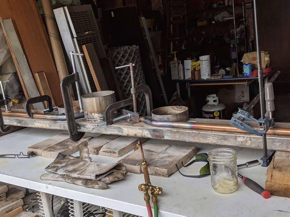

I have made a jig for bending the full length bronze rudder stock. The first test bend with 7/8 steel rod was successful. You can see the bent shaft laying on the old rudder. Note the old rudder shaft is not true near the top and it is misaligned with the new shaft. What do you guys think?
Re: Rudder Shoe
Looks like you have the bending sorted out. As to alignment maybe the old rudder and shaft were slightly misaligned or they were different angle because the keel groove and upper fiberglass tube are out. Either way, I guess you can tweak the bend to fit the boat or adjust the pintles and gudgeons for best fit.

Hi. I cut up an old bed frame and attached it to my pipe bender making a press to bend the bronze straps for the rudder. I also made a die to press the straps into by bending a piece of steel. I have been practicing on bits of aluminum. At first the bender warped the straps. You can see it in thinner the piece in the background in the image below. It splayed out the fingers. When I straighten out my jig, it fixed this issue as shown by the thicker part in the foreground. The 1/4 inch plate used for this last bend required heating or it would break. What about 1/4 inch bronze straps? Should I heat them? I don't have much bronze to spare for testing. The pro in the "Working on a Woody" video above did not seem to use heat.

Hi. Cold bronze test strap bent well except for a slight bow which you can see running vertically on the left side of the freshly bent strap in the attached image. The surface of the bend also developed a slight "orange peel" texture from stretching. Do you think heat would help reduce these effects?
Re: Rudder Shoe
Heating until it just begins to turn red makes metals easy to bend but I don't know if it does any harm to your bronze alloy. In stainless I know it can adversely effect the corrosion resistance properties. Maybe take it to a local metal fab shop for an opinion. Or there may be some fabricating forum you could ask.

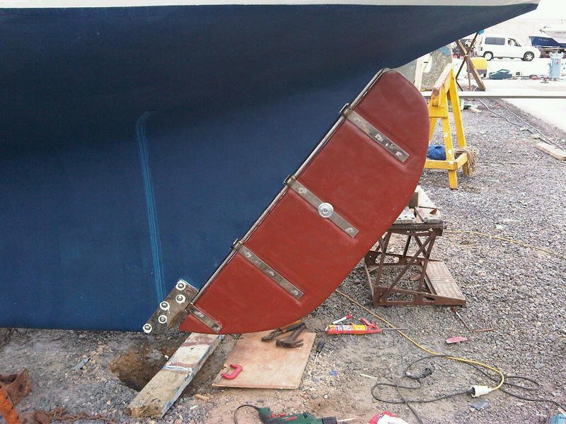

Hi. I am trying to decide on the rudder strap/gudgeon layouts as shown in the pics below. I plan to install a lower rudder bearing and a shoe and either one or two Alberg 30 style gudgeons. Either 4 of 5 straps. To match the neutral buoyancy test I should use one strap per foot, ie 5. The small elbows represent the gudgeons. If you look closely you can see the outline of the full size rudder lofted on the paper. Also you can see that I bent the first and longest strap using a little heat. Any comments would be appreciated.
