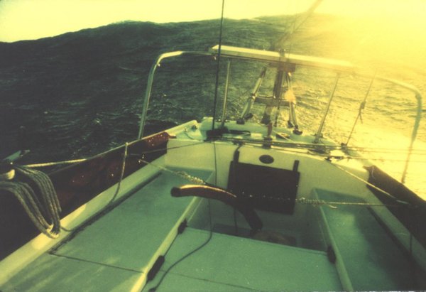

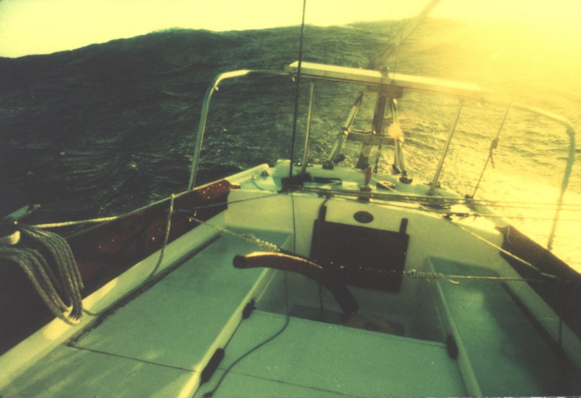

Here's a shot of Atom rounding the South African Cape with an Aries.

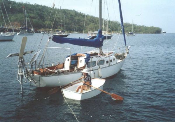

Here's a shot of the same Aries I took off Atom and added to my friend's Taipan 28, which I then sailed for him from Venezuela to Brazil via an Atlantic circle.
