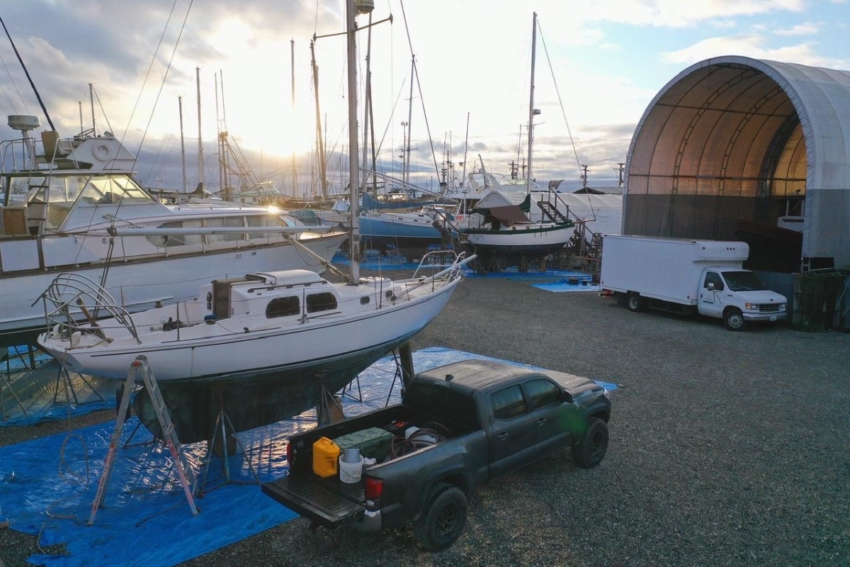

Went out to Port Townsend today to do a few things on the boat. She’s in a non-working storage yard right now so I was somewhat limited.
Having her moved to the working yard next Friday to service the engine and systems then will be sailing her to Everett where she will be hauled out onto my trailer and towed home!

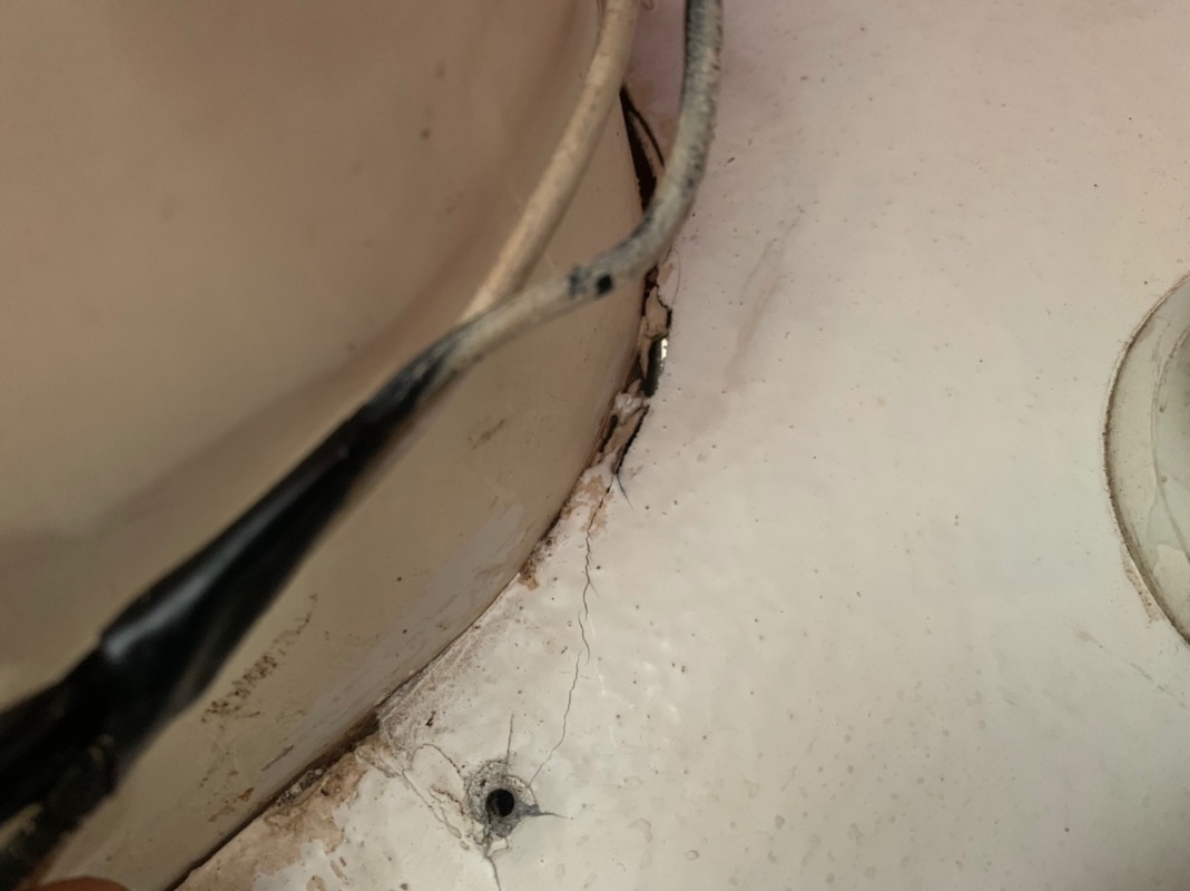

1) Cracks around where the main Bulkheads meet the coachroof - doesn’t look like they have ever been tabbed?

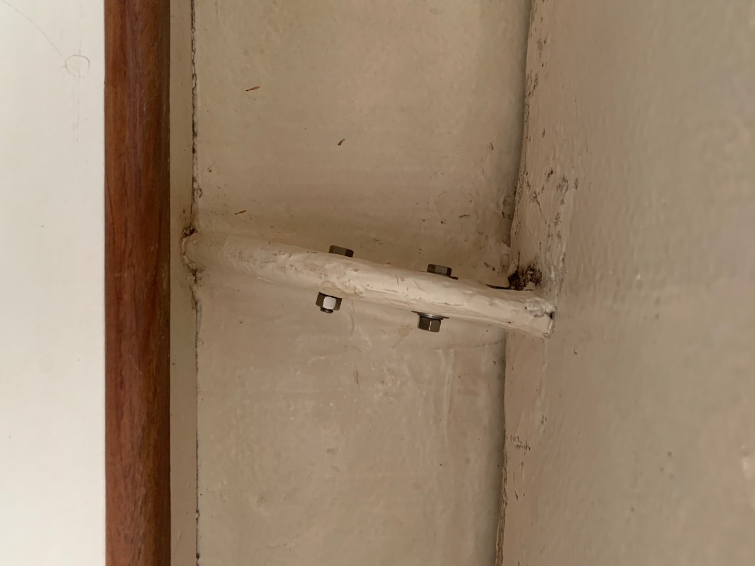

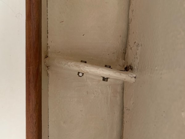

4) starboard forward chainplate knee is at an angle whereas port is closer to straight up and down

Daylight seen between bulkhead and coachroof

Forward Starboard chainplate angle

Many boat builders only tabbed one side of the bulkheads with glass and most of them have held up OK over the years. If you don't see any sign of the tabbing on the other side coming loose, you can ignore it or just add tabbing to strengthen it if it concerns you. I usually add it just in case something might come loose in the future and to stiffen the structure.
The forward chain plates angle in this case should not be critical either. If the chain plate is undersize you may develop leaks due to movement though. I usually replace them with 1/4 x 1.5" stainless plate. While I don't worry about the angle in your photo I do try to angle the plate toward the mast in the vertical plane.
