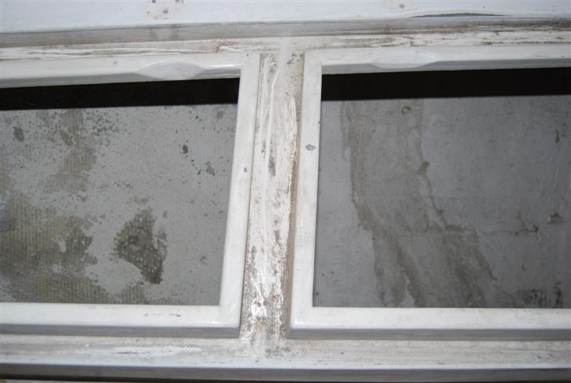

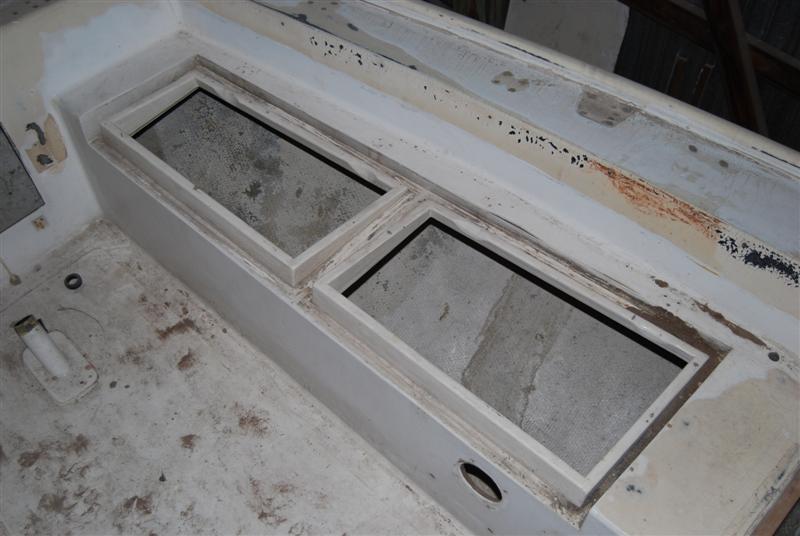

Here are the pictures from my Triton. I forgot to take pictures of the lids.
Dan
Dan
