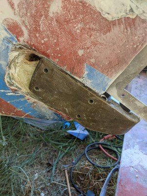

Hi. When I was installing a rudder shoe on my Pearson Triton hull 554, I discovered a false keel filled with foam. Should I open the keel or the false bottom inside the boat to access this area to layup glass? Thanks, Ken.

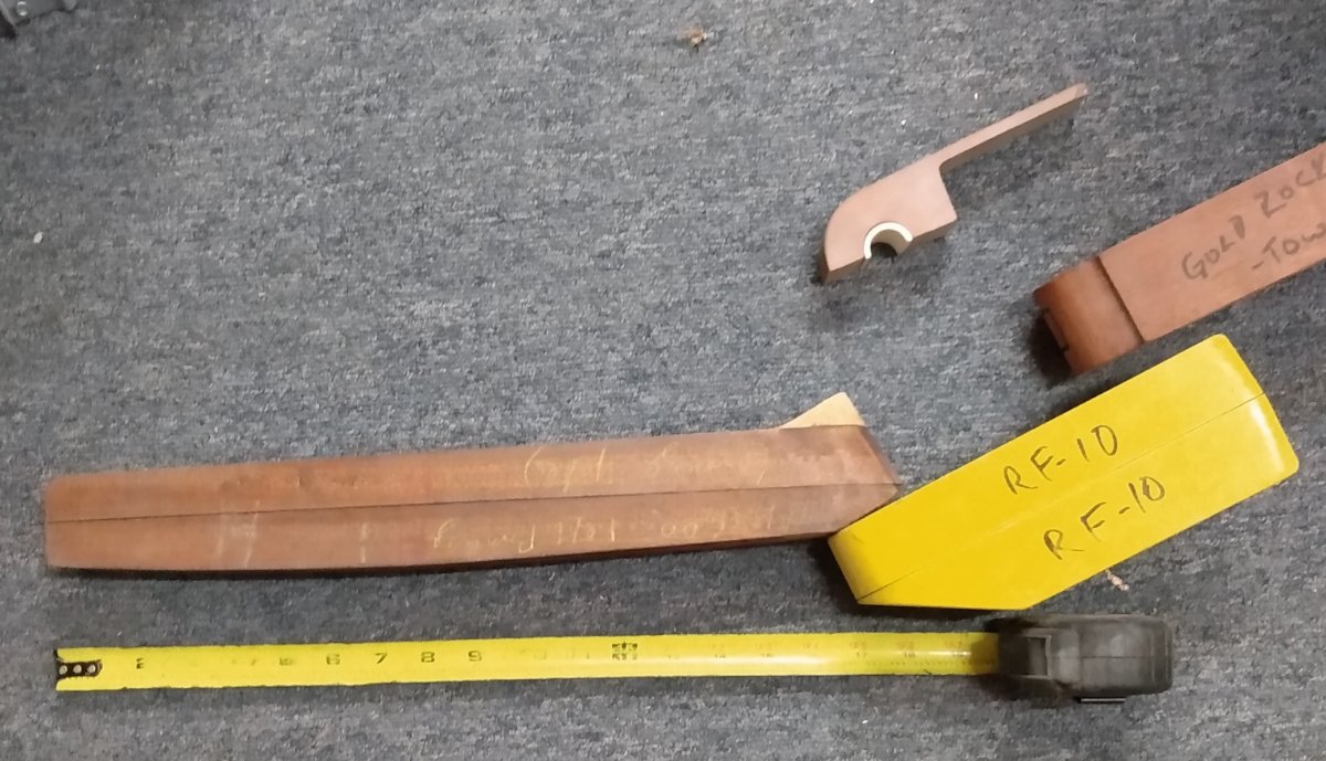

Thanks for the reply. Pete at Port Townsend foundary cast it for me from a mold he already had. It was not designed for the Triton but is looks bomb proof. The angle of the straps don't match my hull exactly so the forward end was resesed deeper exposing the void in the hull. I will lay up glass on the inside to compensate for the shoe notch as you suggested. I'll send you a picture of the mold when I get to my computer. Ken.

The yellow RF-10 pattern is the one Pete used to cast my Triton's shoe.

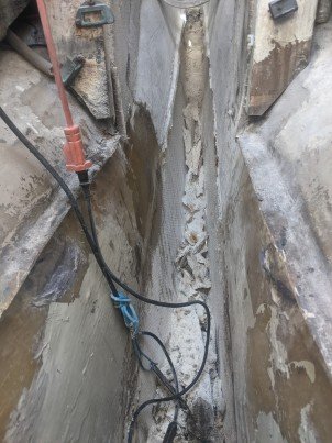

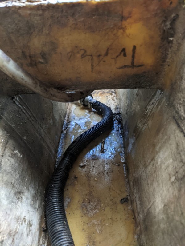

On my East Coast Triton (Hull number 554) it measures 20 inches from cabin sole to the bottom of the bilge. There is only room for the bilge pump at the bottom and then the bilge slopes up to the stern tube.
The picture below is from the engine bay looking forward under the battery box showing the slope of the false bilge. If you look closely you can still see the drill bit piercing the false bilge through 18 inches of foam.

From an earlier thread on Triton keels someone explained the false keel that is supposedly only found on pre hull #382 external ballast Tritons so yours must be internal with no false keel. If yours is internal ballast, either the factory or a previous owner must have added the foam and some glass above it. The good news then is that you have a very solid keel instead of the added false keel.

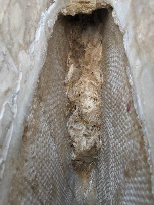

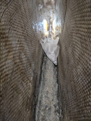

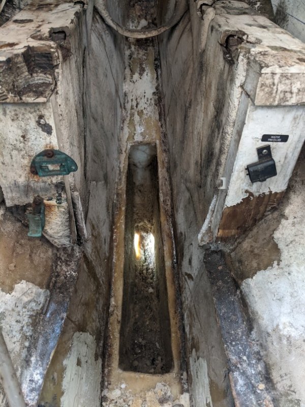

After removing the battery box and the aft section of the cabin sole, I cut through the resin-rich bilge cover with a multitool. The glass was about an inch thick at the bottom and half an inch thick at the top. Here is the opening between the inboard engine mounts. After digging out the foam, you can see light coming in though the holes where the rudder shoe straps will be located.

By the way, the foam smells strongly of diesel which must have entered the false bilge through its many surface cracks. The top of which seems to be pure resin. I am leaning towards removing the false bilge entirely, glassing as necessary to strengthen the shoe area, not filling the space with anything and painting.
Re: false keel
If it was my boat I'd cut out the remaining false bilge bottom, apply fiberglass and thickened resin as needed to support and seal the rudder shoe area and paint it all with white epoxy barrier coat Interprotect 2000e. The reason I use that in bilge, cockpit lockers and chain locker instead of a single part paint like Bilgecoat is because it goes on easily with a short nap mohair roller and is tough against chafe and water and can be glassed over in future if you decide to make further repairs and modifications such as adding an integral water tank into the otherwise useless aft bilge area. Two coats applied a couple hours apart covers well.

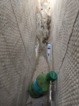

Re: false keel

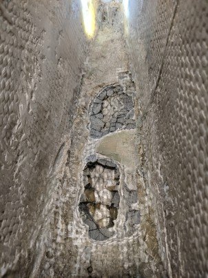

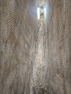

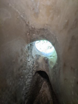

The view facing aft between the engine mounts of false bilge removal project. It turns out that the remaining lip of false bilge surface can be snapped of with hammer and a chisel. I don't think I could do this if the false bilge surface was part of a hull/false keel joint.
As a newbie, I still want to make sure that there is no joint and the hull was made in one piece. On the exterior, I scratched off the bottom paint above a spot where the hull/false keel joint would be but there was no sign of a joint. On the interior, I washed an area that I ground where the surface of the false bilge was (center of the above image and sightly to the left) and I am trying to make sense of what I see. I was expecting the woven mat from below to continue above the joint. Maybe it is hidden by resin the factory used to cover the foam in the false bilge. Below is a zoomed in shot of this area. Any comments would be greatly appreciated.

What we know about the construction history of these newer boats with internal ballast plus your own observations on the exterior confirm you don't have a false keel situation so that disappearance of the woven roving in the photo could be thickened resin on top of the roving. If concerned you could grind into a small area and see what you uncover and then add some glass over it. Or just add a couple layers of glass to the area anyway to help compensate for the glass joint you removed. In any case, you might as well add some glass in the lower bilge around the shoe and carry it up the sides as high as you want.

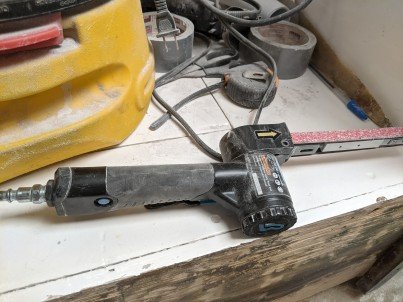

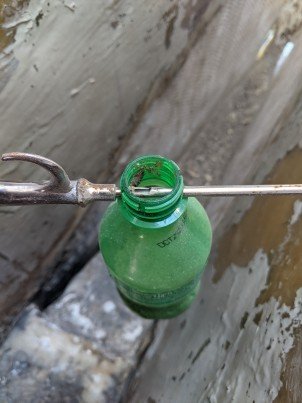

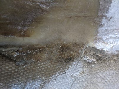

Thanks for the comments. Glassing over the resin globs sounds right. However I had to figure out a way to prep them as they were covered by what I call peanut brittle. The peanut brittle is formed when the foam adhears to the resin. You can pry it off with a screw driver but it's tough. The resin globs have so much tecture that is is virtually impossible to get the stuff off. Below is a top-down view of the lower glob showing the stuff. A clear patch of resin can be seen in the middle where I chipped off the peanut brittle.
After chipping away at the stuff, I thought why not sand blast it? I made a cheap DIY sandblaster from youtube. It is made from a harbor freight blow gun that cost a few bucks and has a notch that I filed in it to allow sand to enter. Sand is placed in the bottle, it is then capped and rotated around the nozzle to allow gravity to push the sand in the notch. Fire up the compressor and you are in business. The thing actually works!
Here is the upper and lower resin globs after sand blasting

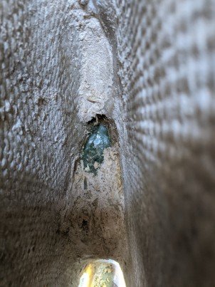

For the past few days, fresh water has been seeping from the foam around the lead ballast into the aft end of the keel where I want to glass. Any ideas on how to speed up the drying process?
Re: false keel
Maybe someone else can give you an idea but meanwhile you could drill a hole inside and outside in likely spots and if it doesn't drip out fast enough drill more holes in other spots. Maybe try compressed air for the outside hole or a vacuum on the inside one. You could also try a moderate amount of heat under the keel after drilling. If you still have a slow drip you can build a temporary dam to stop the water getting to the aft area you want to work in or if the leak is slow enough, block the water with towels until the glass repairs cure. Should only take a few hours and then you can seal the entire bilge after the leak stops.

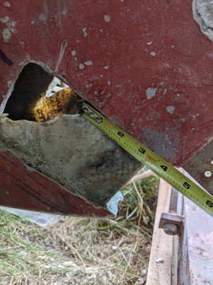

Re: false keel

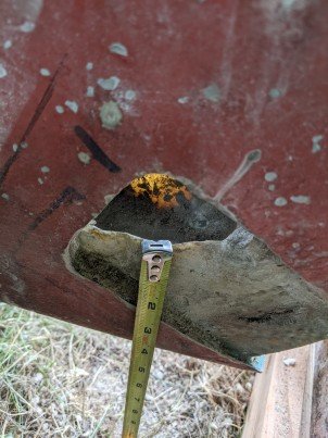

Hi Ron. Here are the pictures. I measured the thickness to be approximately 4 inches from the rudder shaft groove to the interior and the same from the bottom of the keel to the interior. The hole I put in my keel lets you see the inside and outside at the same time. Not good for keeping water out of the boat but it helps to see how thick the hull is. Ken

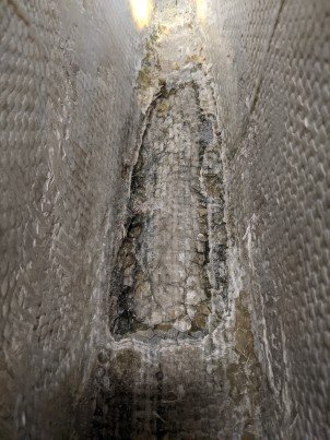

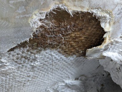

As I was grinding a taper in the glass joint where the surface of the false bilge was glassed to the starborad side of the boat, I noticed that a screwdriver slid easily under the glass. A little pressure popped off a big chunk revealing the same roven mat as lower down in the bilge.
This is proof that the hull of Triton 554 was layed up without a false keel and an interior false bilge filled with foam was added later. Here is another pic of the same area after some more grinding. You can still see the false bilge joint on the port side of the stern tube.

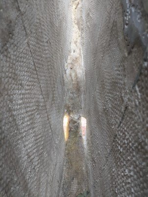

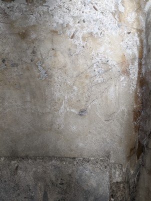

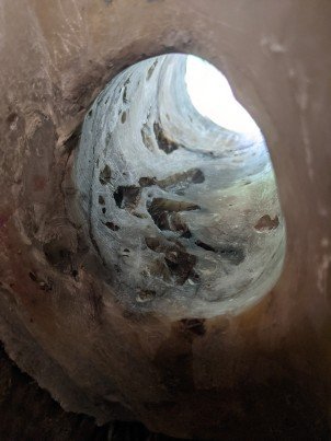

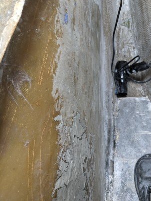

Anyone know if these cracks are serious? They are on the starboard bilge wall and bottom of the bilge but not the port side. They seem to be superficial since they don't continue though the taper I ground in the glass on top of the ballast.

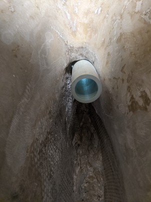

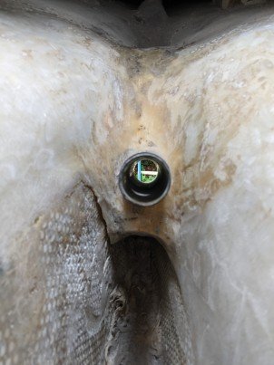

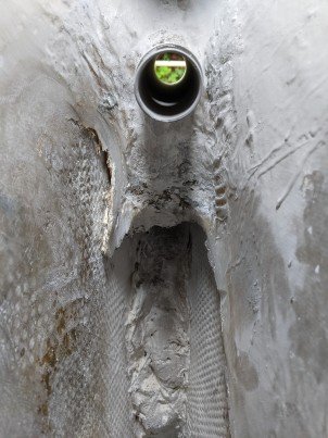

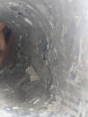

Hi. The delamination of the false bilge runs under the stern tube which is cracked both inside and outside the boat. Should I replace the it and gind out the last of the delamination?
- PXL_20210707_211942958 (1).jpg (25.35 KiB) Viewed 430843 times
- PXL_20210707_212008380 (1).jpg (33.58 KiB) Viewed 430843 times
Re: false keel
Hi Ken - Is the stern tube itself cracked, or just the glass around it? You are planning to repowering with an inboard?
The seeming likely bilge add-ons and those cracks, makes me wonder if she wasn't banged hard on some rock at some point, hard enough to require repair. I think I'd go ahead and grind them, then lay up some new glass there as it really won't be that much more work. I doubt that one layer of - what is it, 10oz or so? - glass will make a big difference, but you are there now with access and it'd be pretty easy to do...

Thanks for the reply. The stern tube is solid glass. Is was turned down on the inboard end to accept a dripless seal, making it look like two pieces. Yes I plan to reuse the yanmar inboard. I will post a shot of the exterior portion of the stern tube when I get back to take boat.

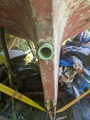

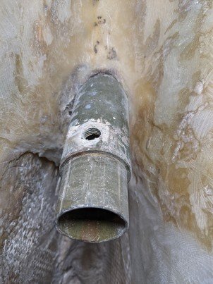

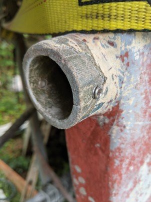

Here are some of the cracks on the exterior of the stern tube.
- PXL_20210707_223250511 (1).jpg (30.27 KiB) Viewed 430819 times

Re: false keel
I ended up replacing the stern tube. I used a router and a 60 grit flap sanding drum on a die grinder to remove the old tube, after first cutting off the exposed portions with a multitool. Since the stern tube is perpendicular to the deadwood, I freehanded a router to remove the first inch of the tube. The die grinder worked great on the rest since it could reach the entire length of the tube bore. The starboard side of the tube bore is the connected with the delaminated piece of fiberglass of the false bilge surface shown a few images above. The tube has voids on the same side as the delamination. I am thinking of grinding out the voids and the delamination. This would not remove any of the actual hull- just the delaminated skin interior to the hull which made up the surface of the false bilge.
- PXL_20210718_211124126 (1).jpg (38.49 KiB) Viewed 430575 times
- PXL_20210718_211152342 (1).jpg (22.01 KiB) Viewed 430575 times

Re: false keel
By the way, some of the voids in the stern tube bore had water in them. FYI here is the die grinder I used to remove the stern tube. The flapper drum began its life with a two inch diameter but prior use has worn it into this spherical shape. This shape was good for enlarging the 1.5 inch ID of the stern tube to 2.0 inches.
- PXL_20210718_211316262 (1).jpg (52.5 KiB) Viewed 430521 times

Re: false keel
Here is a closeup of the voids in the stern tube bore after cleaning out the sanding dust. When I shoot compressed air through one of the voids it comes out inside the boat beneath the delamination which you can see in the lower left corner of this image. I'm struggling with how to repair the delamination. Perhaps I could inject epoxy into the void to bond the stern tube bore with the hull? Any suggestions would be greatly appreciated.
- PXL_20210719_201424567 (1).jpg (24.03 KiB) Viewed 430526 times

Re: false keel
I decided to go ahead and grind out the stern tube bore voids (and delamination) since they essentially drain to the bilge. You can see the roven woving on the starboard side of the stern tube and in the image without the tube where the glass just popped off indicating that the starboard side of the stern tube bore was not bonded to the hull.
- PXL_20210719_230511866 (1).jpg (23.69 KiB) Viewed 430501 times
- PXL_20210719_230442860 (1).jpg (15.39 KiB) Viewed 430501 times

Re: false keel
In the previous image, the dark bands in the resin below stern tube opening indicate delamination. I got a new toy and continued to remove this damaged resin. Finally I ended up removing it all. The fact that you can see woven roving most of the way around the stern tube opening indicates that the tube was not well bonded. I will rebuild it with epoxy and glass to hopefully get a better bond.
- PXL_20210723_223159683 (1).jpg (33.09 KiB) Viewed 430399 times
- PXL_20210723_220503271 (1).jpg (18.83 KiB) Viewed 430399 times

Re: false keel
While prepping the bilge for glassing where the the rudder shoe pierced the hull, the bottom of the bilge needed to be sanded. Under the top two layers of mat was an inch thick layer of cracked resin. Chunks could easily be popped of with a screw driver. Underneath was the actual bottom. So, my boat's bilge has a bilge! Since I want to make a structural addition to the hull to support the shoe, I decided to remove this loose stuff. There appears to be some cracking in the roving on the bottom. This is the only place where I have seen any possible hull damage. I plan to remove the cracked resin from the ballast lead to the rudder shoe and to lay several layers of roving in addition to the 1708 I was planning to lay to strengthen this area. Does this sound sufficient.
- PXL_20210729_234200472 (1).jpg (41.18 KiB) Viewed 430192 times
- PXL_20210730_003134140 (1).jpg (37.72 KiB) Viewed 430192 times
Re: false keel
It does sound sufficient but if you want to add more strength against shocks from say hard groundings in waves then once you add the roving you can also add an inch or so of thickened polyester resin and then more glass on top using whatever resin you prefer. Overall thickness gives more strength than just a thinner section of just fiberglass.

Re: false keel
Thanks. I will rebuild as you suggest with thickened resin. The old resin layer does not seem to have been thickened. Perhaps the new thickened resin layer can also be strengthened by mixing in some chopped glass to prevent it from cracking.

Re: false keel
The good news is that sanding the bottom roving with 120 grit removed what I thought were cracks. It seems the "cracks" were print-through from the cracks in the resin just removed.
- PXL_20210731_214122734 (1).jpg (36.33 KiB) Viewed 430151 times

The rebuild begins with some thickened epoxy and peel ply over the grooves in the lower gudgeon resin block to prep it for glass. You can see in the image three plugged holes approximately 1/4 inch in diameter. They were drilled through the keel by the previous owner and filled with wooden dowels. I assume these holes were drilled to drain the old false bilge. Two of them are vertical and their dowels can be seen at the bottom of the image. The third is horizontal through the starboard side of the keel and can be seen to the left of where I have folded the peel ply on a diagonal. Anyone have suggestions as to how to deal with these holes? Currently I do not have external access to the forward vertical holes due to the trailer but I can probably access the horizontal hole from the outside.
- PXL_20210805_000444738 (1).jpg (38.17 KiB) Viewed 430040 times
Re: false keel
I don't see why you can't do your repair of the holes from inside by either drilling out the wood plugs and filling the holes or leaving them in place and glassing over them. You didn't mention why you can't do that so I must be missing something here. To finish off the repair from the bottom you should be able to gain an inch or two of clearance between the keel and the trailer bunk board by using the screw pads to lower the bow and raise the stern. It's possible because the bottom of the keel is not flat. I always put two short 2x4 boards crosswise under the keel when setting the boat on the trailer so there is clearance for lifting straps, access for bottom repairs and painting but maybe you didn't do that for some reason?
What is the peel ply for? If you're using it to avoid amine blush or to smooth the surface for doing the epoxy work in stages with no sanding between stages, why not just do most of the work all at once, wet on wet layup. The thickened epoxy goes on and smooth it out best you can with some spreaders and then a brush with resin on it and then start laying the glass on top and as you press it down and wet it out it further smooths out the thickened epoxy underneath. I've never used peel ply in this type situation so not sure of the advantage. But again, not knowing your whole repair schedule, I'm lost.
