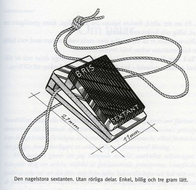

Of interest to me is Sven Yrvind's "Bris Sextant", a tiny device he uses to takes sights. I have not used it but find it intrguing to no end.
http://www.yrvind.com/bris-sextant-for-sale/
- bris_sextant.jpg (38.49 KiB) Viewed 6798 times
