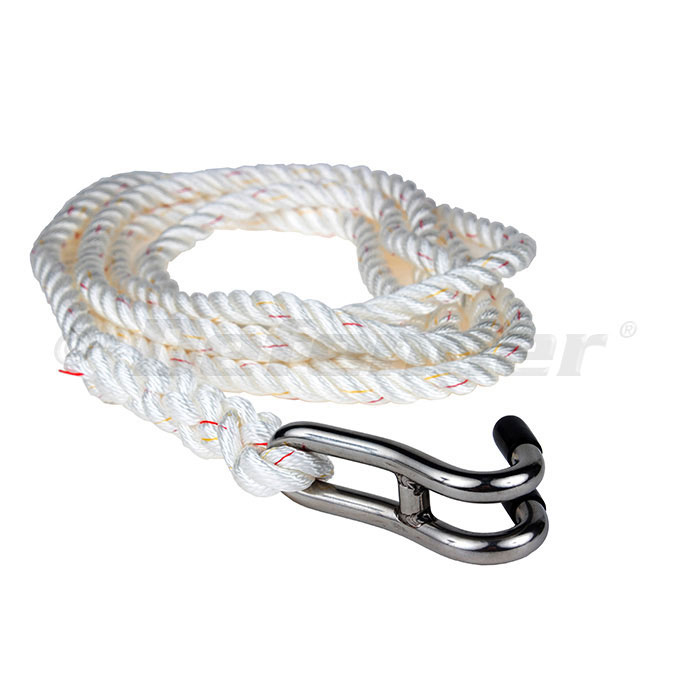

2) C.S. Johnson* is now manufacturing a Captain Hook Chain Snubber (I ordered this and thought it looked nice in person but there was a problem with it so I had to send it back - I can't remember for sure now what it was, but maybe it didn't fit the BBB chain properly). A Florida company called something like "Best Imports" sells one that is the same shape but I would steer clear of them due to problems with payment/delivery - documented both by people I know personally and online reviews.
Captain Hook Chain Snubber:
http://www.csjohnson.com/marinecatalog/00043.htm#bot
(I see that Defender sells the C.S. Johnson hook as well)

Hi Nanette,
As I remember it the cranse iron side tang was suitably beefy. I know we didn't drill a new hole but used an existing one. I think I remember having concern about the stress on the side, but after hundreds of nights at anchor (not all smooth ones), all did seem well and there was no evidence of stress.
I don't remember the block being extra special (although it might have been a snatch block because we had it on hand), but I will check into it for you and get back to you with more detail.
On the snubber cleat: I think I would get a piece of line and check out the various leads and potential chafe points. The rod looks like it could work well if there would not be too much chafe, or, what about mounting a cleat in place of the (proposed) chock?
Re: Anchor sail
Okay, I spoke with my cruising bud and straightened out my memory on the snubber system we used. Actually, the conversation was kind of funny considering it was something we both used every night for well over a year. "But I'm sure we had a block, and wasn't it on the starboard tang?" "Well it might have been there, but remember the shackle that.... wait, let me go look at the bow..." Etc, Etc.
So, the evolution in summary:
In the beginning, we attached the snubber at the lower end of bobstay, as is customary.
Then, we spent some time in a very rolly (and consistent) anchorage, which led us to experiment with a method the Pardeys recommended. Counter-intuitively, this involves running the snubber over the end of the bowsprit. Experimentation in the consistent-yet-rolly-pitchy anchorage showed that this was noticeably smoother so we kept it, although it did evolve (we also used a flopper stopper in that particular anchorage).
In iteration one of the end-of-bowsprit method, we attached a block to the starboard side tang of the cranse iron, and ran the long snubber line back through this block and back with the rode over the roller and to the bitts. This had the advantage I mentioned earlier, in that with a long snubber, you could use about half the length, and leave the rest piled on deck by the bitts. That allowed for a bit of midnight "Hmm, I think I'd like to let out just a bit more chain" without having to bring in the existing, veered chain to redo the rolling hitch.
What I had forgotten was that we decided we didn't like using the starboard tang on the cranse iron, and when we moved to the center tang (details to follow), we just couldn't get a good lead coming from the block back to the roller. That would be different on each boat, and if one could get a fair lead, it would still be a good way to do it, I think.
Like you, we didn't have a spare hole in the lower (center) tang, which was where we wanted to run the snubber. So what we did (and which I had forgotten when I posted earlier) was to replace the clevis pin that held the upper end of the bobstay (to the cranse iron) with a long shackle of which the pin was the proper size and strength rating (as compared to the clevis pin). So now we had a shackle that hung down from the center tang of the cranse iron, and it did not require an extra hole. The strain was no longer on the side tang, but our fair lead was compromised. So we eliminated the block and instead spliced a thimble onto the snubber line and attached that to the shackle. So that shackle was now the inboard terminus of the snubber; the outboard end continued to be attached to the chain rode with a rolling hitch.
With that we lost our midnight quick-and-easy rode extension capability, but kept the comfortable geometry of leading the snubber from the end of the bowsprit*, and had no chafe issues (we pulled in the rode/snubber and re-made the rolling hitch if we wanted to veer more chain, just like is typical).
I hope this helps. Neither of us could find a good photo of this, but let me know if I can clarify it (and if I do find a photo, I'll post it).
