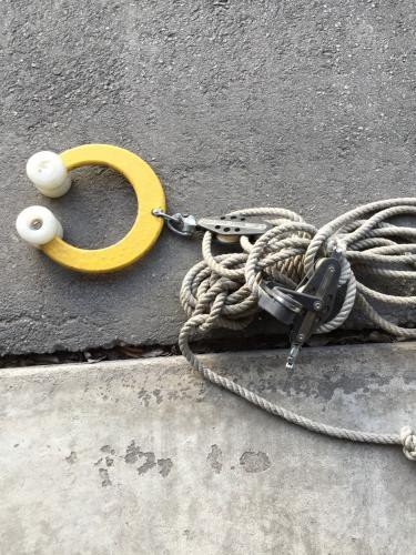

3) If your sail is in good shape, I don't think the vang will significantly affect your luff tension. You do have the downhaul to fix that if it is the case. If you have or can borrow one of these (below), you can test vang placement before drilling holes in your boom.
HTH!
