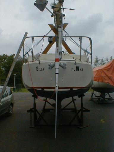

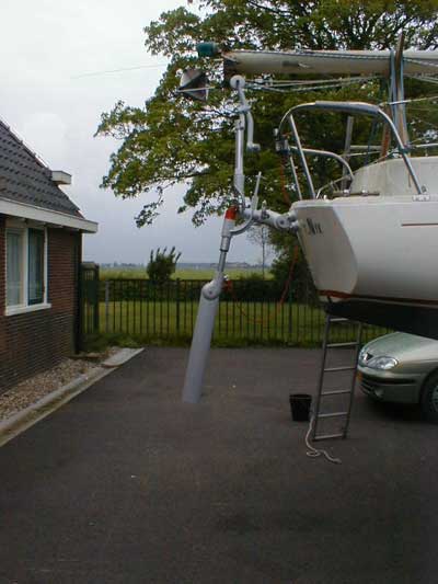

'Sin Tacha' turned 38 this year, so is no spring chicken. I've seen so many Vegas with Navik vanes on that when I see one without, it looks naked!LazyGuy wrote:I would love one except I can't bear having something so hideous looking hanging off the transom of the boat. I know, how shallow to let aesthetics prevent me from having something so handy but that is why I own a 40 year old boat rather than a 10 or 20 year old boat.
The vane rates right up there with the dodger and cabin heater on my list "necessities" :-)
Rachel, that Cape Horn is a beautiful installation! I understand it was designed for an Alberg 30, so fits the Alberg series of boats very well.

This is a common misconception. Wind vanes are not just for going offshore. I put mine on as soon as I get out of the bay, unless I'm just messing about and want to hand steer.LazyGuy wrote:Add to this that I have no intention of going "off shore" I really don't have a need.
Sailing with a vane is far more efficient than a powered autopilot, not just because it draws no current, but because it keeps you at a constant angle to the wind and obviates the need to constantly trim sails.
When beating to windward you get the most 'bang for the buck' because the boat remains as close to the wind as possible, and adjusts to every subtle change. Tell-tails indicate the sails are always in perfect trim.
To tack, you simply twist the vane head around to the other tack, let the main look after itself, and tend the jib sheets. The boat comes about in a controlled manner without losing power, and proceeds on the other tack.
When sailing in gusty conditions the vane allows the boat to round-up for a gust, spilling wind from the sails, then resumes on course as normal.
A vane also teaches one how to better balance one's sail plan to suit weather conditions. I've run downwind in light air, wing-on-wing, for hours without touching the helm. This gives me far more time to enjoy cookies and hot chocolate :-)
The Navik, now discontinued, only weighs 30 lbs. My other favorite, the Pacific Windpilot Light, weighs 28 lbs, both pretty moderate for a small cruiser.
All that aside, there's something magical about watching a boat sail with a vane. It's a hypnotic dance between boat and wind and wave, each moving to it's own rhythm, yet all in concert with each other.
